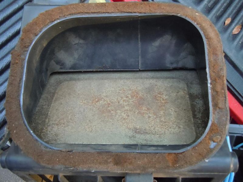

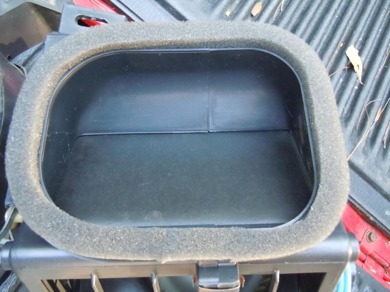

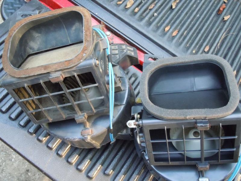

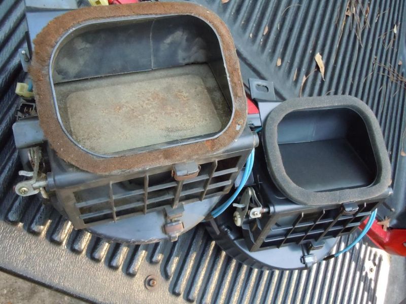

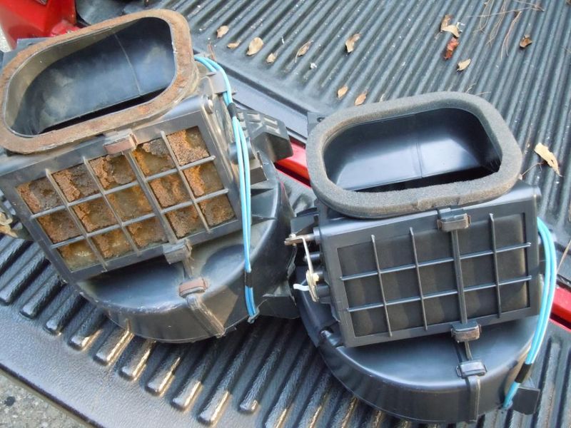

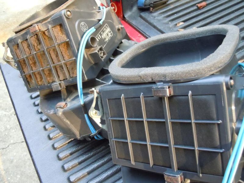

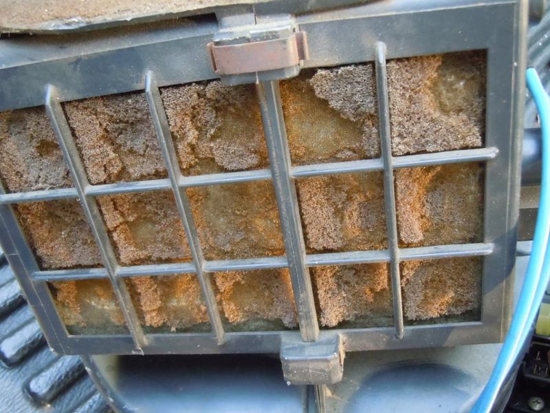

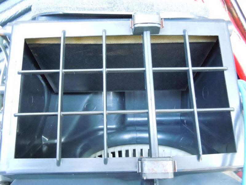

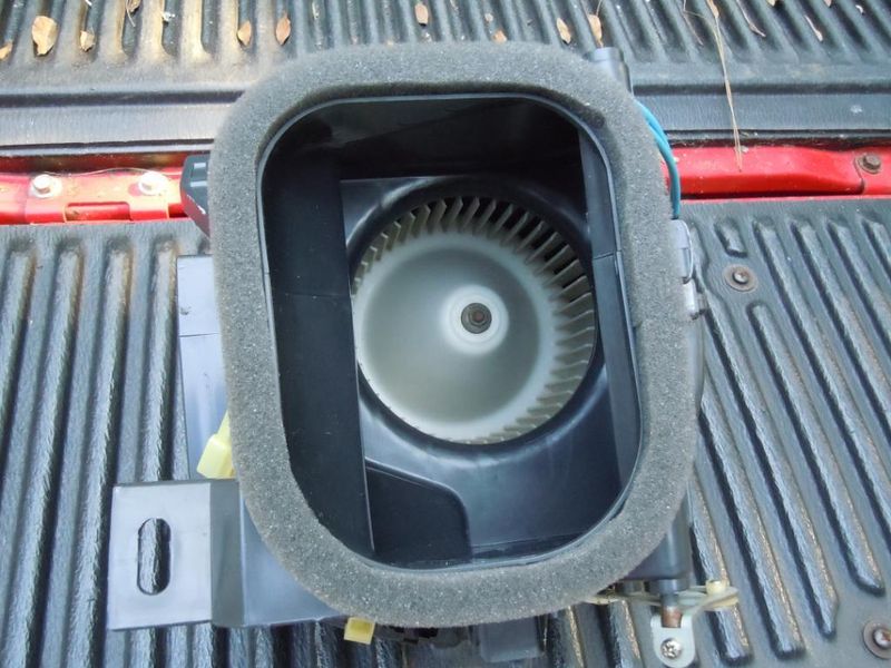

Looks like you have a 1987 truck so you should have the good flap door on the blower motor housing. This is the flap door that lets you either have "outside air" coming into the system or "recirculated air" depending on where you have your selector knob positioned.
The earlier trucks have a flap that is vinyl covered foam over a steel plate, whereas the later trucks (probably 1989 and up) just have a foam covered steel plate for that flap. As the foam on that flap ages, it starts to disintegrate and will no longer seal the incoming air from the cowl when you have it positioned to recirculate the cabin air.
To see what I mean, here are some comparison pics!
These are 2 blower motor housings, the one on the left is a later model unit and the right is a unit that I installed the earlier year flap into........this is from my 1989 truck and it used to have that foam only door in it.
Right now the flaps is in the "outside air" position.
This thing ain't gonna seal nothing!
Here they are in the "recirculated air" position and the blower motor will draw air from inside the cabin in this position........the flap is supposed to close off the incoming air from the cowl area in this position.
The earlier style door seals up good!
Not so much on the "foam only" door when all the foam disintegrates and you just have a steel plate!
A pic of the top of the blower motor housing showing how it is a straight shot for the outside air that is pulled in from the cowl area when the flap door is set at "outside air".
A pic from the side when that door is set at "recirculated air".
If your wanting the most heat in the cabin, you definitely want to have this set on "recirculated air" and not outside air.

i know for a fact i have that dilapitated one on the left that shits gets everywhere when u touch it....i want the one on the right please.....send to me or i will freeze to death... nah its not that cold up here.... this sounds logical but wouldnt i feel the draft when i run no fan... i prefer fresh and mostly run it that way....i have in all my mazdas...wait let me go look right now... yeah no still on fresh....hmmm wierd i know i see it in my guage but thats a hole nother story i have a wierd temp sending unit in it since the crate motor place drilled and tapped it to a wierd pipe thread that wouldnt accpet any mazda temp sending units...
