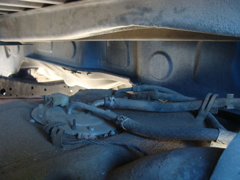

does anyone have a pic of there wiring for there gas tank sending unit or know where i can get one to look at my wiring broke when i replaced it all and now my gas gauge doesnt work any help would be great thanks

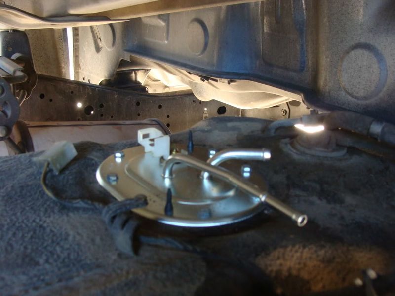

Is this what you're looking for?
With the connector connected to the sender on top of fuel tank, 1988 B2200, manual transmission (mechanical fuel pump).
With connector disconnected.
