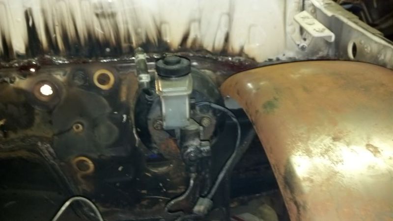

ford feista bolts right up no issues. here is a pic. i just installed it last night and i am in the process of sheeting the firewall (as you can see). Im going to flip the clutch linkage around. and i am tubbed out for 20s.
Lomazda92
DOES ANYONE HAVE PICS OF THE CLUTCH LINKAGE FLIPPED, ALSO WHAT YEAR MASTER IS THAT ON THE FIESTA.
