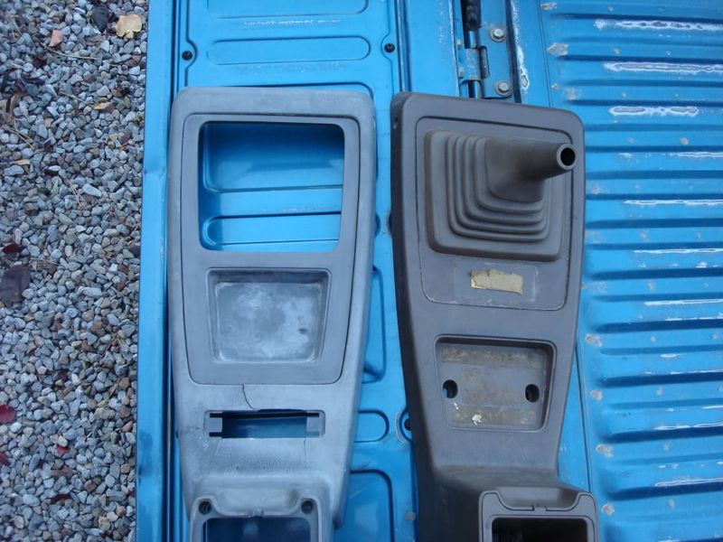

I will start by saying that I am no expert but and some of this is just speculation. I have been looking for a center console since Jan and when I looked at pictures on here I started to notice that there where to diffrent designs. Then I found one in April and tried to put it in it was 6in off the floor in the rear. Then last month I found the other style and it fits perfectly. I have heard from many people on here that there is no differences between standard and regular cab but that is the only thing I can think of but they are for two diffrent floor designs. Here are some pics to show the diffrences.
The one on the left is much wider and fits in my extended cab. It also is much diffrent around the shifter in fact the whole piece comes out of the wider console.

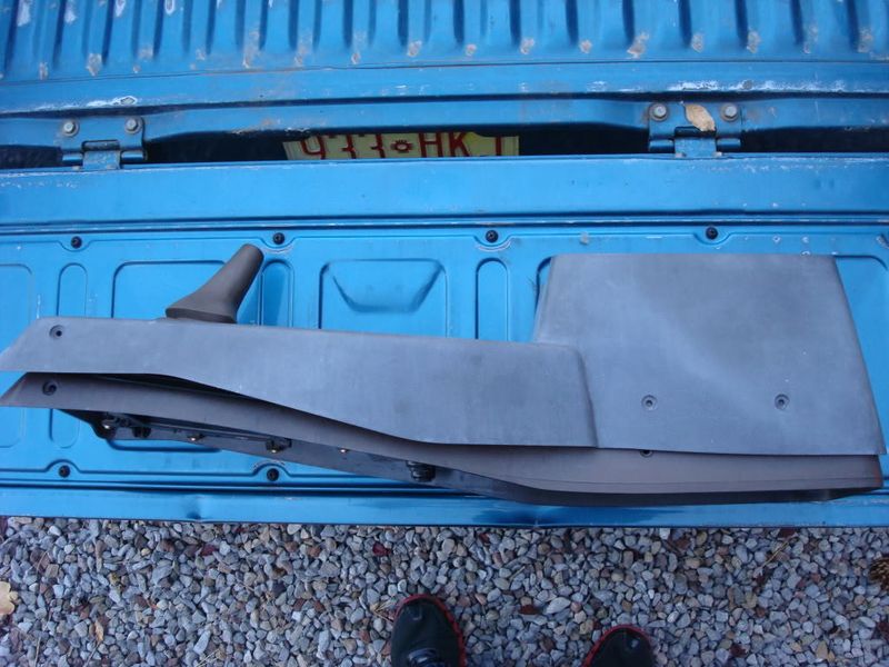

Here you can see the differences in the floor contour
Here you can see wider one with the kick out

one could be from a 4x4 and the other is 2wd
i would imagine they use a different floor pan for the clearance of the transfer case

or the bigger pocket one is out of a 2600i 2wd liike my budys his looks just like it and its a 2wd and the other one looks just like mine

The bigger one is out of a 4X4 truck extended cab, but it fits perfectly in my 2wd extended cab. I did just realize that they are both b2600 trucks maby the floor in the b2600's are diffrent and it is not really a diffrence of standard or regular cabs.

We have both styles you showed above, the left one is a perfect fit to my 91 2.6i ext cab, the other is the perfect match to cortnye's 2.0 single cab, we pulled hers out of a single cab 2.2 that had factory bucket seats in it at the junkyard. Mine was stock in my truck when I bought it. I think its more a difference between single cab and extended cab, I think the 4x4's head their own console for the double shifter setup for the trans and transfer case.

Some do some don't. We happened to find Single cab with buckets, all factory, and it had a shorter center console than my ext cab. That's the only reason they should be different. Different floor pan between single/regular cab and the extended cabs...
