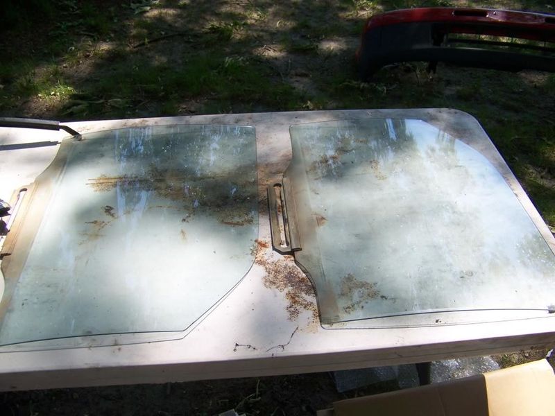

here is what you will need, i got this stuff from nc4life

Hey bob wasn't a piece on the driverside vent window broke?

mikey, yep, it was rusted through. very simple piece to make, couple holes and two bends, spot welded in, copied the pass side
one of the hinges was broke too
whats the chances of finding new rubber for these?

I got an extra driverside window assembly that's rusted at the bottom but has a good hinge on it.
