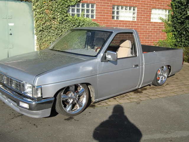

if i end up gettin a bagged hardbody can i still be on here or is there a nissanscene? i didnt see one...
Nice ride no nissan scene I have no mazda and im still here lol

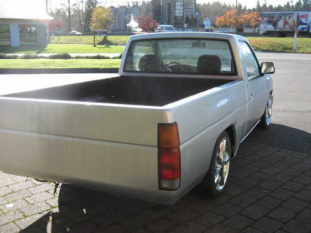

If you are still going to look at it pay attention to where the body work has been done. Look at the seams where the tailgate would of been for cracks, especially inside the bed on the tailgate skin. Many people install those with out either protecting the metal from the other side, not welding a full seam, or making good welds.

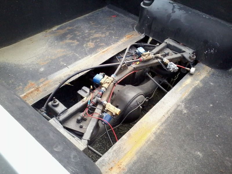

Look for exposed wiring any where especially in the bed and the engine bay. That would be signs of amateur wiring because nearly all wiring has been insulated in wire loom from the factory.
Look for any rust on the welds, this could be sign of cracks because a full bead won't have holes for the moisture to get behind and rust from the back.

Nice truck.
I think its funny how all of the, "mini" trucks built in that era look very close to each other.
