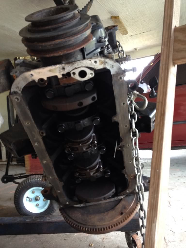

Yep, I did new NPR pistons and rings, new rod bearings, and had the head re-done last October, did all that with the engine still installed.
How long to just do a head gasket? For me - as I've only done it once - I think I could do in one day. It's easier with a Weber. So mark ALL the vacuum lines and wires, that's my hint.

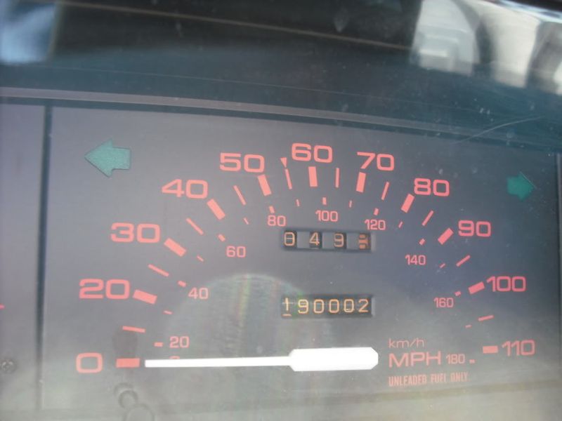

How's it runnin' ??? Pretty damn good. 7K on it since October, ran it 300 miles up and down the Interstate, Arizona heat, mountains just yesterday (broke another %%^#@#$^&**^$ Weber carb throttle return spring, 30 second fix on the exit ramp, I carry a spare). Broke the 190K barrier yesterday.
Like I said: I did new pistons/new rings (NPR), new connecting rod bearings (look at the shape of the crankshaft journals and bearings in the link below), and had the head redone (no cracks). I never had a head gasket leak, owned it for 18 years now, the engine just smoked before, and I felt super self-conscious driving this in the high-dollar area where I work, and I wanted to be environmental for my kids. Parts/machine shop costs were about $700.
