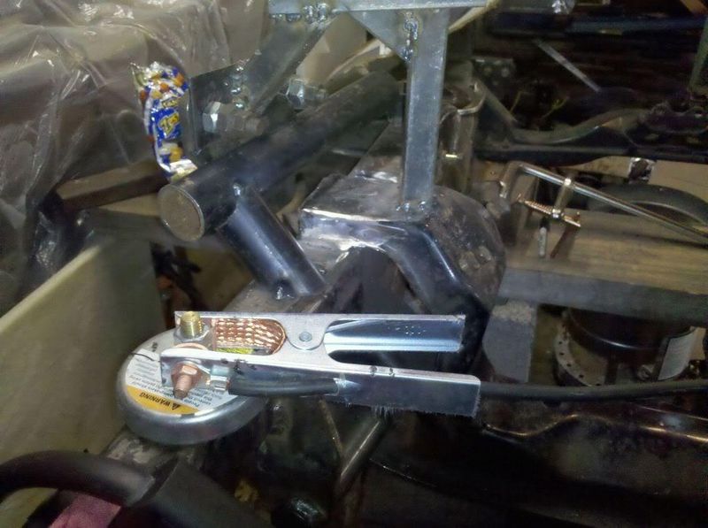

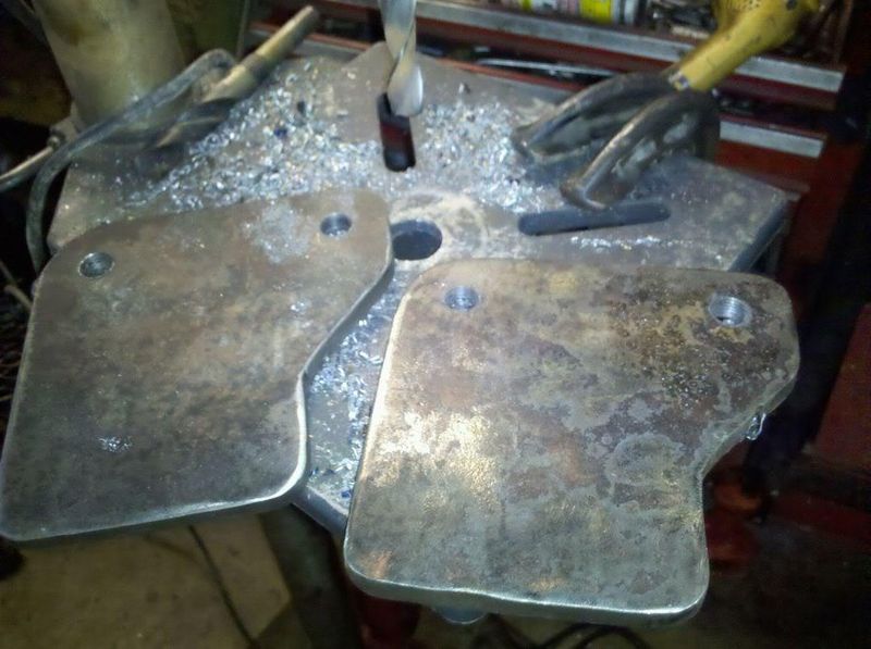

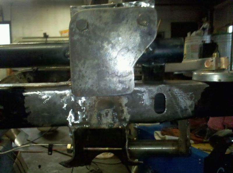

Here's a few of the passenger side...I've got a little more done just no pics yet. I have the basic set up made just got to add gussets and some plate. Then clean it up and onto other side.....then bag mounts.
