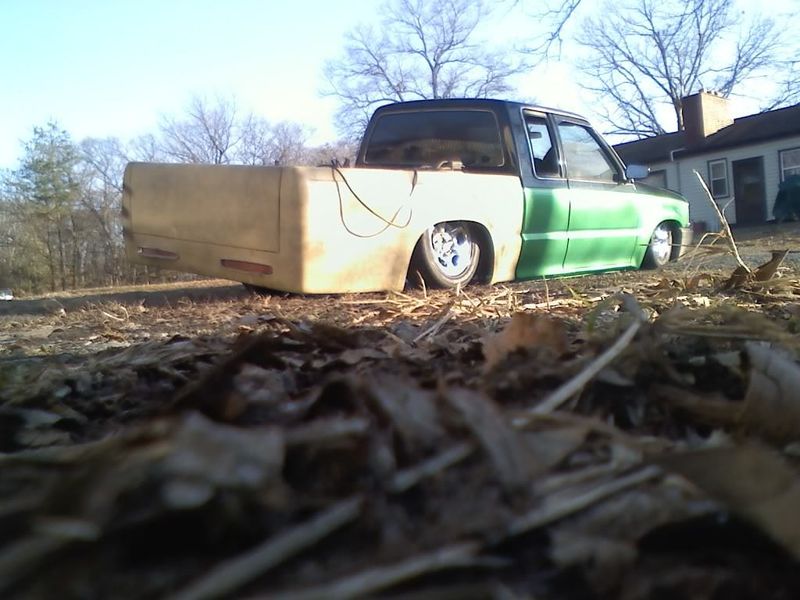

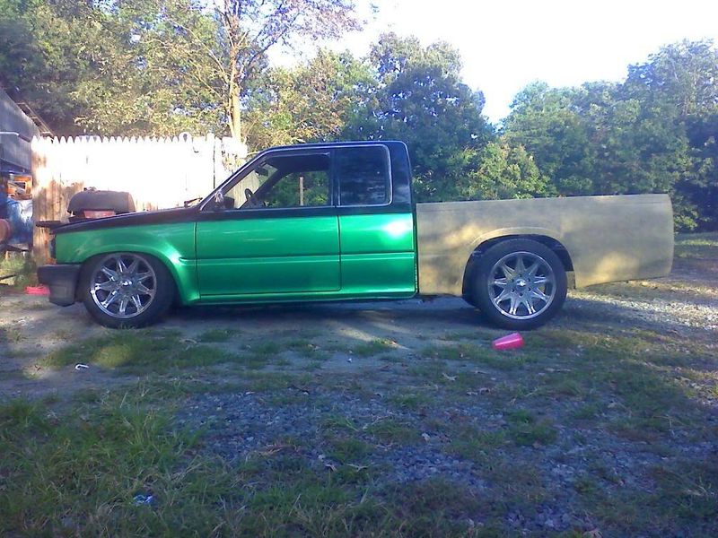

i think it looks good shaved....mine never got any further with shaving than what is pictured but it was looking good....i think..
mazdaman_573
Yeah I mean either way I tnk that the lower looks good done,w the uppers left,anyways.was its hard to do all that? Did u weld in piece or use that green resin
baggedbmy93mazda's avatar
baggedbmy93mazda
yeah i would leave the upper bodyline with lower shaved if anything...that i think is the best look, well unless you dont shave them at all.
welded, thats all i really believe in when it comes to bodywork of that nature.. mainly because of the bed flexing with the bags, draggin rollpan, hitting sides, etc
my door handles only had few tacks on them and used body panel adhesive by 3m.
i crimped it to give it a backer and solid mounting point.
if you have a good fit and material. the body work is easier, so just take your time. i practiced on other stuff i had around the house..
its not really hard at all....there was a lot of filler at one point, but i stripped it down and used my welder to fill in and get rid of bondo and shit, but that took a lot of wire, time , flap disk and other materials too
