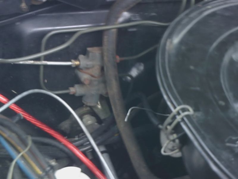

proportioning valve? Booster?

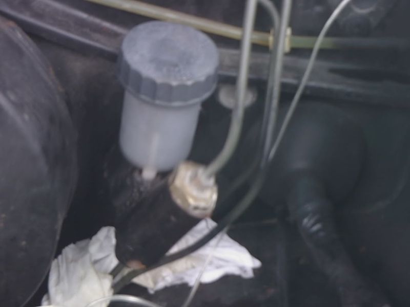

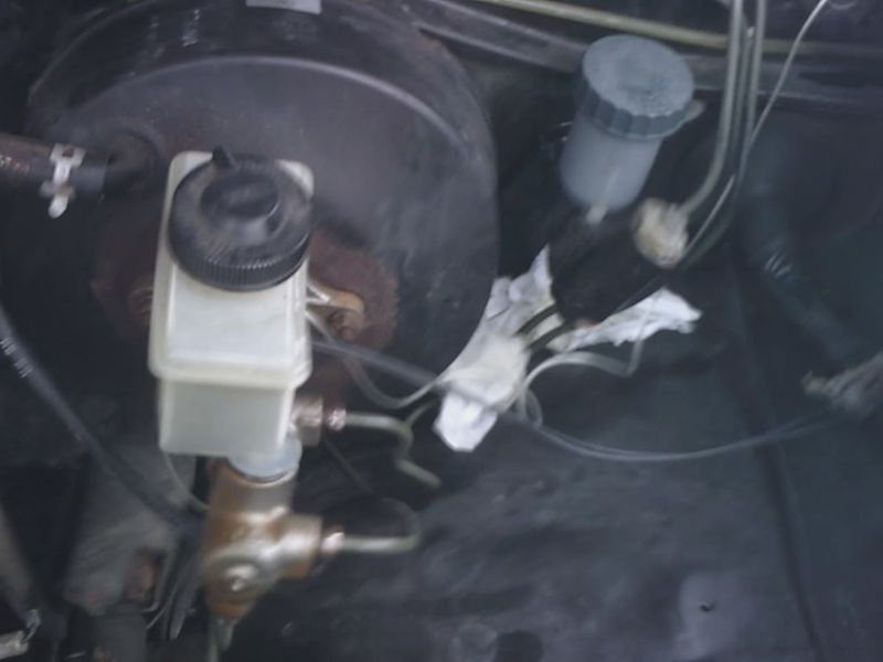

And what exactly is this? lol
Did the previous owner say why he replaced the master cylinder? I wonder if it was an attempt to fix this issue
The last picture is your clutch resevoir (sp)
6
614littleb
Oh shit. I put brake fluid in it......... What is supposed to go in it? tranny fluid? im gonna go drain that out now. .
and no, he said when he got it it barely had brakes... so he replaced it.
6
614littleb
or wait.... ehow said to put brake fluid in it. lmao
