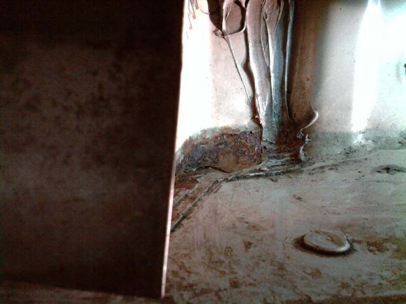

Be careful with this. If you ignore it this'll happen:

Thanks Emjay for the heads up. I did do a little more legwork this morning and I think I may have one of the two leaks tracked down. Fist I pulled the cowl off to get a better look, good thing I did about two cups of pine needles, some moss and a few candy bar wrappers, dang mice. I kept wondering why pine needles, moss, and other stuff would come out of the vents when the fan was on high now I know. On the pass side is the intake for the fresh air and the seam sealer to it is lifting and there is some rust too. I then notice that if I pull the wiper motor out you can see the air intake. I wish I had done this first. I took a hook tool and lifted/scraped all the loose seam sealer away and can see what seems to be where the water is entering. Now I have to wait for it to stop raining so I can treat the rust and reseal that area.

As far as your rust is concerned, that's minor stuff. You will wanna treat it with the wire wheel and prime it none the less, but you seem to have caught this when it was in it's infancy. Use the Rustoleum Stop Rust primer once you get rid of the rust and clean the area, it'll kill any micro cancers that you are likely to miss without sanding (that's what I used and I even sanded it, not a knock of skills at all.)
