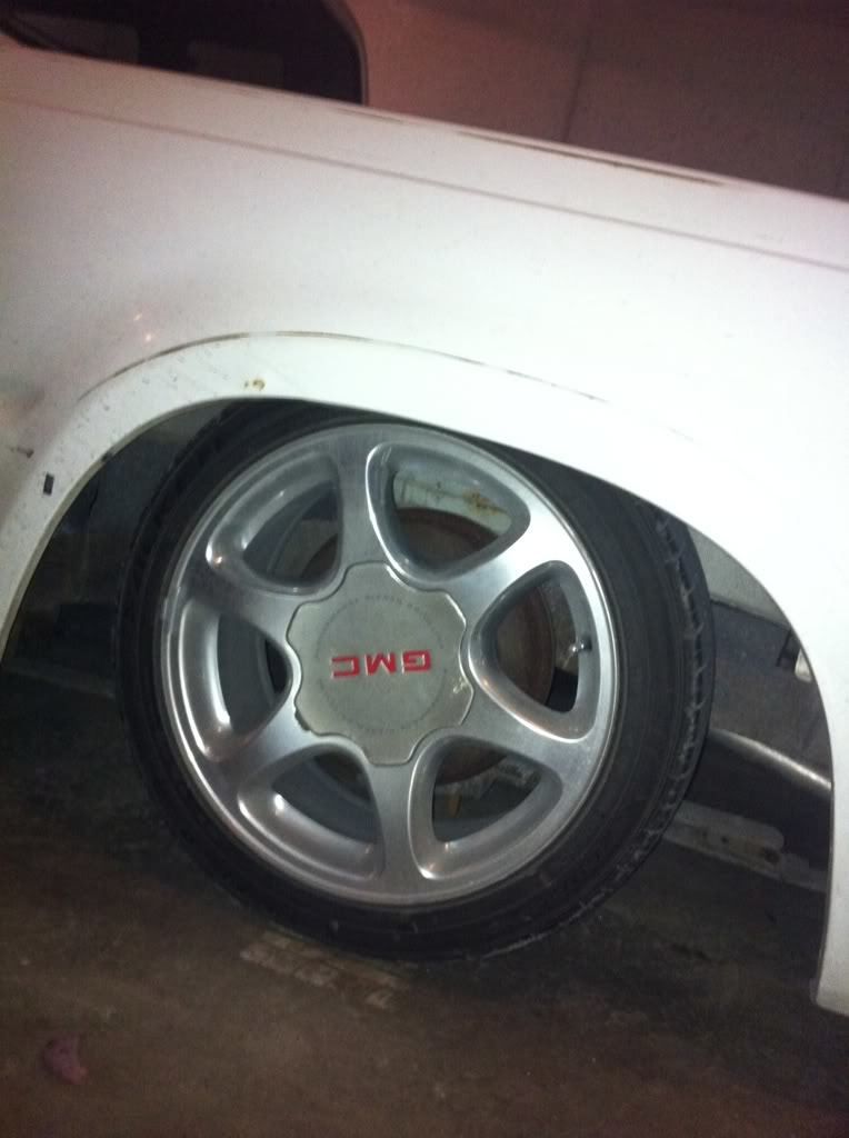

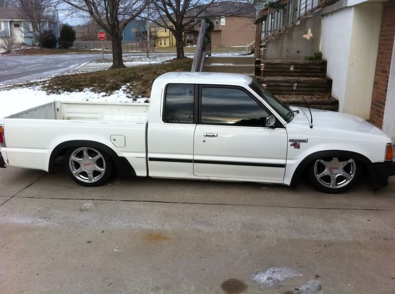

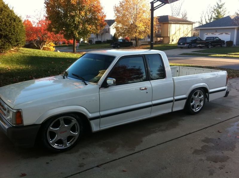

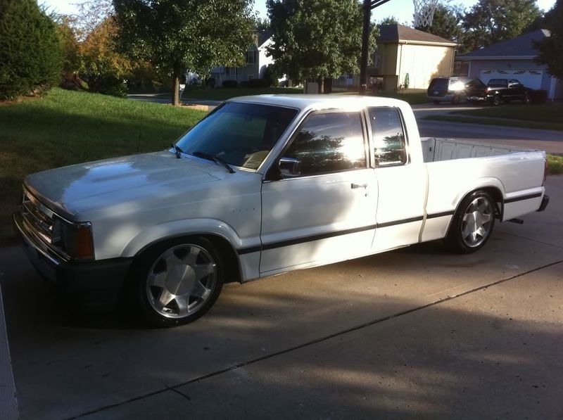

I added air shocks in the rear so i could carry loads and this is how low it sat with no air. sorry bad pic.
