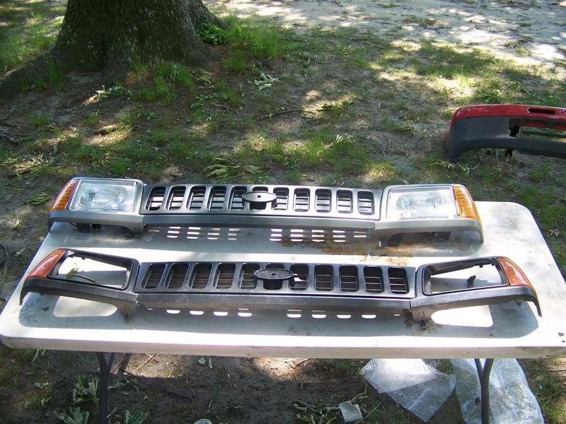

86-95 front end
Stuff needed.
What the front end looks like with the raider headlights. If you don't do the raider headlights you just keep the stock mazda ones.

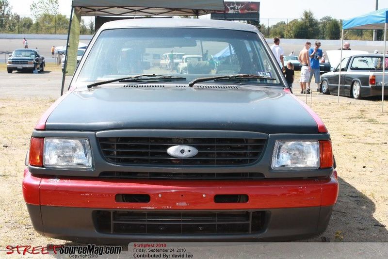

96-98 front end

Yep. If you run the stock mazda headlights this is what it will look like.
The lights in the picture I have at the top are with the Ford raider. They gave a cleaner look since they are flush.
