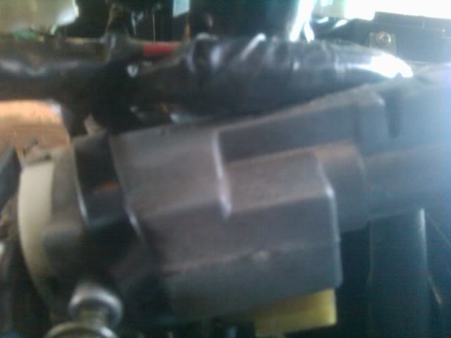

welp....i just messed up my ignition switch. was putting shrowd back around the column and over tighted a screw and put it right through the back of the switch. anyone ever done that before? well i was wondering....any of you guys have one to sell me....and also how do i get it off. and the lil box with the blinker switch and wiper switch?

pics of the ing switch you need,... and i may have a combo colum switch around somewhere

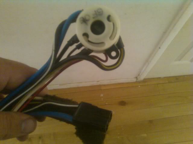

sorry for the crappy pics....

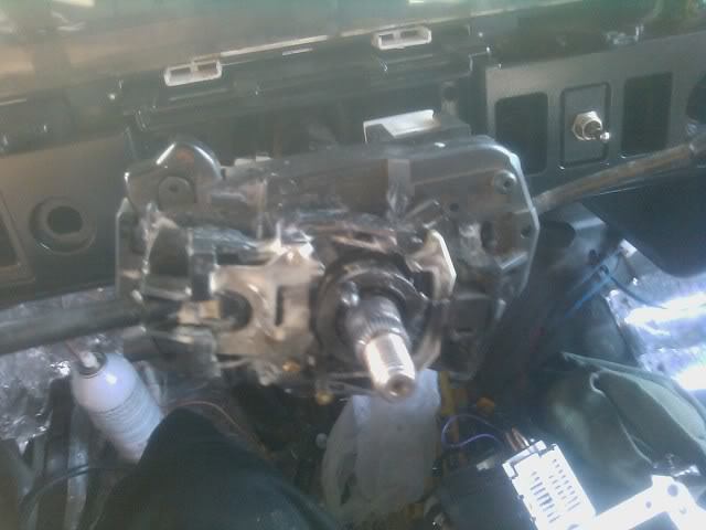

also how do i get this off?

there is a 10mm band around it, and then theres a clip you have to pull up,,,,you can just replace the elec part of your ign, you dont have to replace the whole thing...autozone sales it,there is plugs about 12" down the wires you can undo and unpplug the elec side of your ign

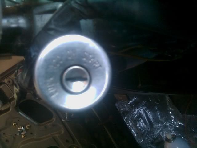

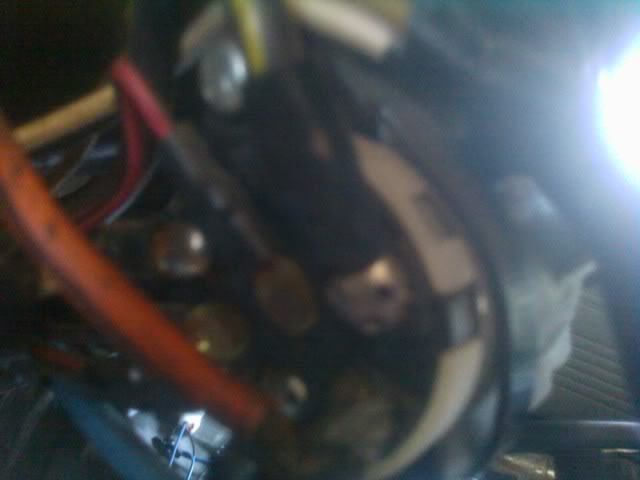

cool got it all off. i broke the lil plastic piece on the inside anyone have one i can buy cheap? they wanted 120 bones at checker autio parts
mazdaman82's avatar
mazdaman82
looks like a junk yard is where you need to go,i thank the mazda mpv had the same ign's some to look in to..old body's not the new ones like the 89 bodys
