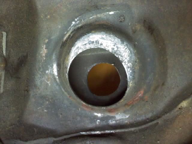

Thanks for the info on the bags an valves, he's also running the slowdown silencers. Now I'm fairly sure that I'll have to spiral cut all the cups except for the rear lowers so they will sit somewhat square. From what I read on the layitllow forum you bolt the upper cup in place of the front shock, the only thing is how would i go about bolting in the upper cup when there's a 2" hole where the hydraulics used to be?

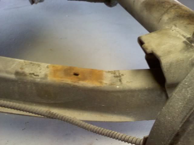

Now the rear lowers would sit on top of the lower arm or should they get notched some to sit around it if it won't lay frame, since this is what he's after.

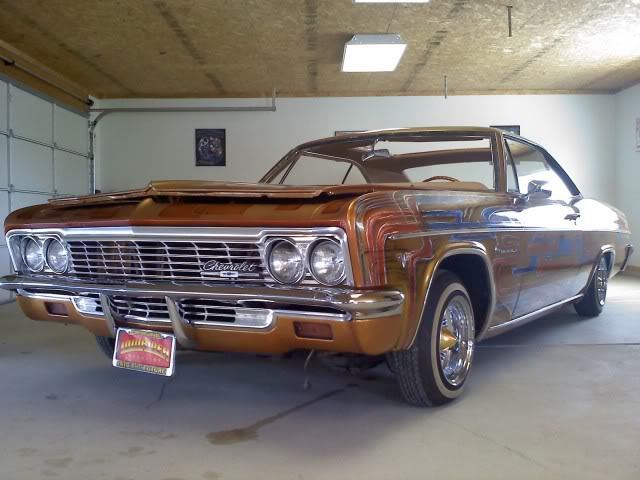

Here's what the car look's like, if some of you have a stash of Low Rider you might find the article in August 99 issue.
Excuse the cell pics if they're blurry.
