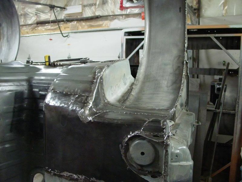

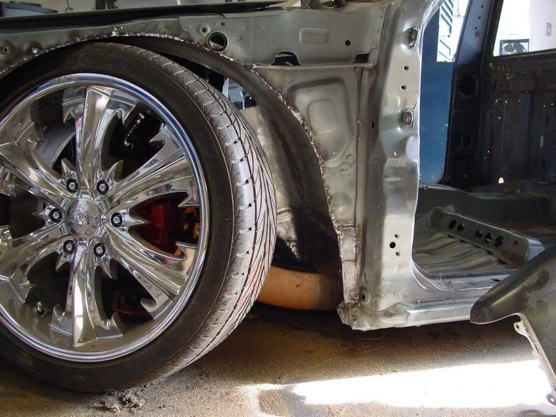

I found some trailer fenders and cut them to fit with a few patch panels but, honestly when i sit back and look at it i feel that i have sorta hacked it together just to get it done. your best bet if your able to weld and have the means to do so is find some 18/20 gauge steel and bend your own. start at the top and make the curve toward to inside of your cab depending on your rim/tire combo. after i finished mine my buddy put a small block in a toyota and built a firewall completely and built tubs the way i mentioned. much much cleaner. I personaly dont wanna present myself as such a hack therefore doing work twice.....i wish i had asked that question. it would seem that trailer fenders would be the obvious awnser but i beg to differ

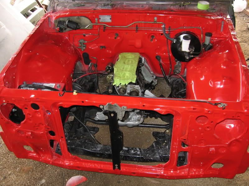

i know mines a nissan but i got my fenders at northern tool and cover about half of the wheel and tire and im running 18's prob could fit 20's though.
*FOIibVfy9cSy1wAVq5rr9xFtuvonFw7urm523UCFbC/innerfenders.jpg?width=737&height=552
mazdawg(mikey)'s avatar
mazdawg(mikey)
i went with stock inners
themdot
Everytime I see that pic, Its like hypnotic or somthing.All I can do is stop and stare...Beautiful..
itslikewhooa's avatar
itslikewhooa
yeah that is really clean... I'm still trying to decide what to do... I bought a trailer fender today for 25$ just to play around with it see if I like it or not... I'm in not rush, I just want to make sure its gonna look good when I'm done no matter what I do...

BTW most trailer fenders I have seen are 16g, and yes it takes time like anything worth doing, but I wanted durability, LOW NOISE, and strength, cuz it repaced a lot of other structure in the front.
anything lighter than 18g would not recieve my OK, for what its worth. lol
Just think of how it would hold in a collision.
Wheel tubs in our trucks serve many purposes, so just put some extra consideration into a few o these points
Oh yeah, I bought a small windshield sprayer kit too. so that saved a ton o space and I can still clean my windshield!
FYI, Princess Auto, for fenders and wiper kit.
mazdamandan's avatar
mazdamandan
btw, I shape 14g all the time, patience and a good set of shaping tools, and knowing how to stretch the steel properly, to get the desired shape
