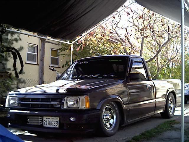

I'm not sure what shade of sealer to put down, a grey sealer then? I have a Mac gun with a 1.4 tip on it. What is "moddeling" never heard of it, that when it tiger stripes? I haven't sprayed any color other than rustoleum solids an primers. Here's what it used to look like
