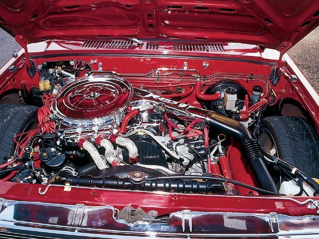

cool, do you have any under the hood pics to show me how you did yours? as far as where you cut out and whatnot

dzminiz's avatar
dzminiz

OK as embarrassing as this is to post after the shot of DZMINIZ motor, here is what my air filter looks like, do they make a cover that will fit it?

yes they do make a splash cover for them, not sure who it was i seen selling them but iv seen them
