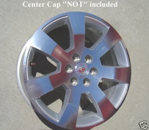

You guys know if the newer model SRX rims will fit a B?
They are 18"x8 6x115mm with a 51mm offset.
I read in the forums that a high positive offset may cause problems if I get it bagged. Is the problem with hitting the upper or lower control arm or the bag/mountings?

Those wheels are the wrong lug pattern. Mazdas are 6x139.7.

man those look awesome.... but thats a high front wheel drive offset... so would have problems wth rubbing parts of the suspension up front and probably in the back as well....

So what's an ideal offset to look for in an 18x8" wheel?
90-b22dawg [andrew]'s avatar
90-b22dawg [andrew]
40
