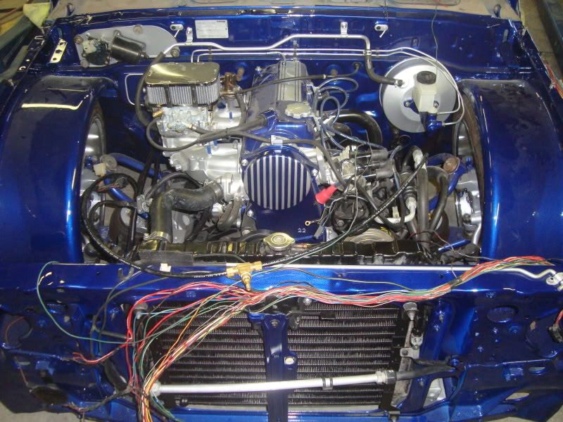

well here is my engine compartment dont know if it helps or not but it is an auto with a weber

For starters. From the transmission, what does this connect to?
idminitrucker (jason)'s avatar
I know its a vacuum line, lol but i havent done the research yet to know where it hooks up on the motor. you can see mine if you look close right about the valve cover (its silver and lines up with one of the break lines even with the silver on the vave cover.) I know a couple people that dont have any of the stuff hooked up on the transmission and it works fine. I will look around and see if i can find the answer.
well i think i have bad news for you and me both. it looks like that line hooks up to a valve on the fender well. (mine is in the garbage) and it bumps the idle up on the factory carb when you put it in gear. same valve bumbs the idle up when the A/C engages. basicly to help the truck from boging down. so you may just have to have a higher idle so when you put it in gear it will run. hope that helps.
