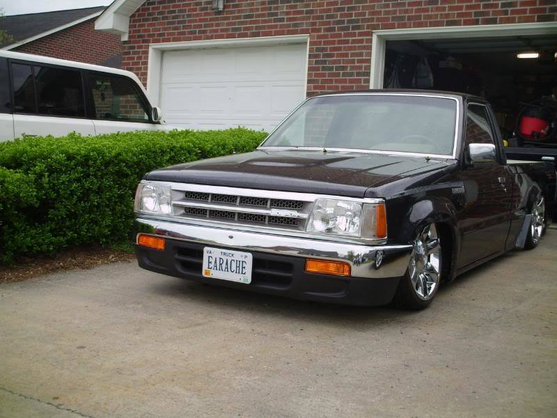

I BOUGHT A SET OF RANGER HEADLIGHTS OFF EBAY. AS OF RIGHT NOW, IVE CUT MY GRILLE SO THEY WILL FIT. BUT IM NOT SURE HOW I GO ABOUT MOUNTING THEM... DO YOU HAVE ANY IDEAS OR PICTURES ON HOW THEY ARE MOUNTED?

Mount your grille and use it line up the headlights.Then drill hole where so the bolts can go throught the core support.You will need to remove the plastic adjusters off the bolts on the headlights.Got to a hardware store and get nuts and washers to fit.You will need 2 nuts and 2 washers for each bolt so you can adjust the aim of the lights once mounted.
