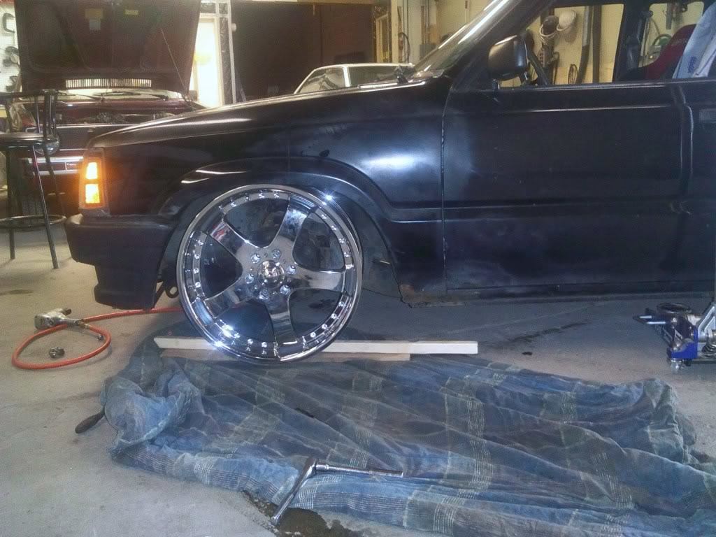

Hi I have looked around and found nothing about wheel offset for just a static drop, I am looking at 20x8.5 with wither a +18 offset or a +25. I just need them to tuck a tiny bit front and rear, I will also be running no inner fenders and rolled front and rear. Any input would be great as for tire size I will also take advice more than likely will be stretching a tire.

Prepare for the future and get the highest offset you can...+30 and higher

With a 20x8.5 you will need at least a +40mm offset. Also what sheetmetal are you running 2wd or 4wd?

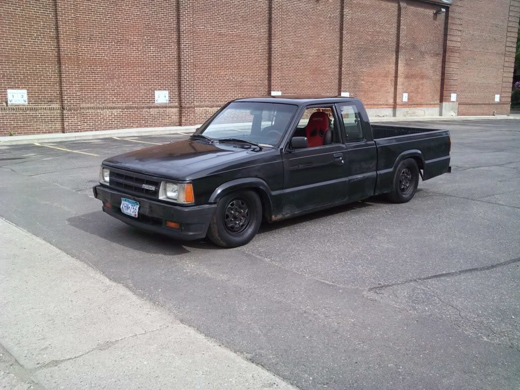

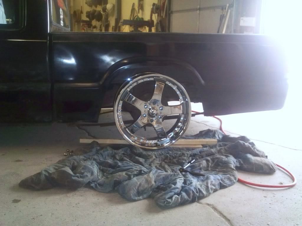

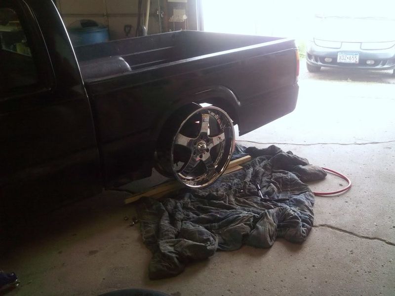

I am running 2wd metal, I also dont plan on bagging this truck. As for the front I may raise it a tad for the wheels if need be and the rear will be getting c notches sometime this week if I find the time to do it and may be going down an inch more.

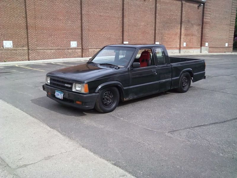

Here is a pic of the truck as it sits now.

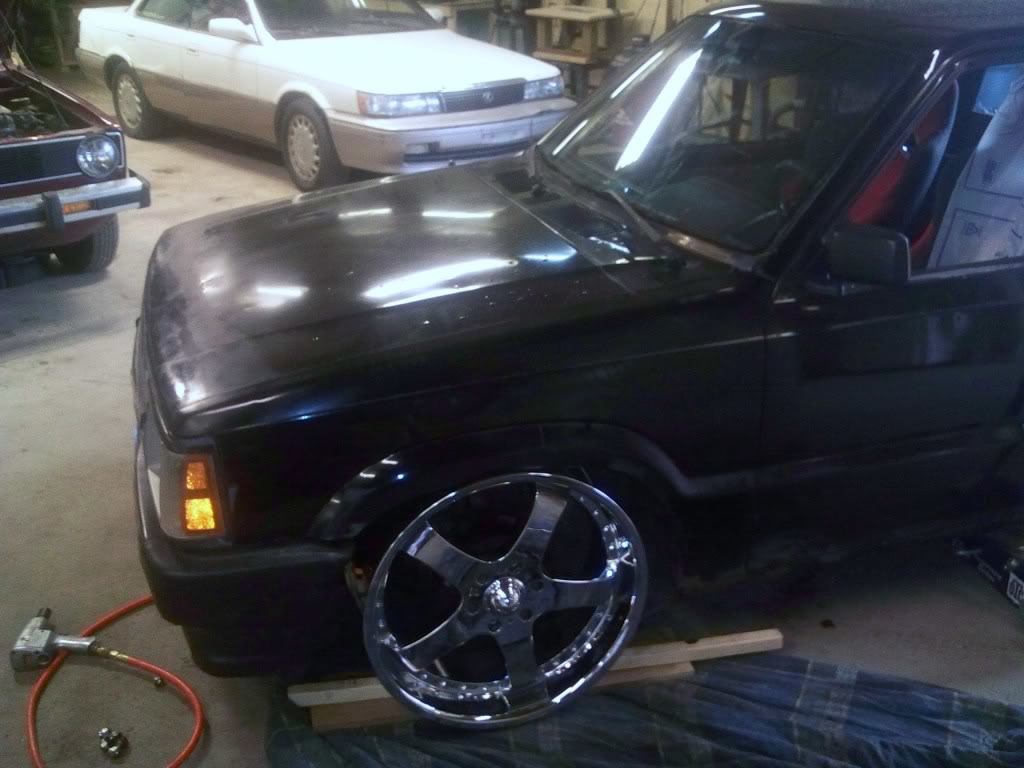

Test fitting 22x8.5 +18 offset just because we have them sitting around I have not ground down the tabs so the arent exactly flush up to the hubs
