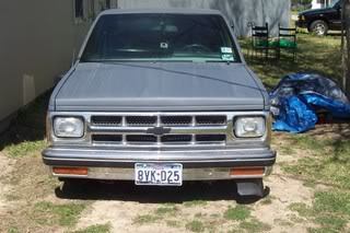

mrs.projekt94
okay, so i have a 93 dime, and while i didnt build it, my friend did, and it doesnt lean to one side. it sits even. I dont know what he did, but dont go hatin on the dimes.Dont forget in the pic of my truck, the truck is not sitting on even ground, its sitting on a slope in my yard so of course its not going to look even. But it is.
