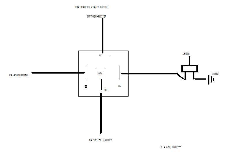

bjv7022
so what do i hook the main feed to the compressors to?

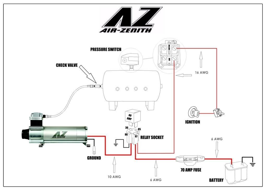

This might help.
bjv7022
so i need to put the pressure switch in series with the ignition line to 87.
then hook up the battery feed to 86?
90-b22dawg [andrew]'s avatar
90-b22dawg [andrew]
best to do it like it shows.... i did mine a little different because im running an edc instead of an electric compressor
