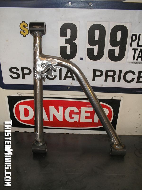

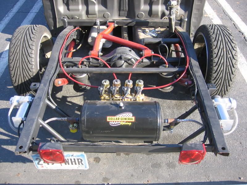

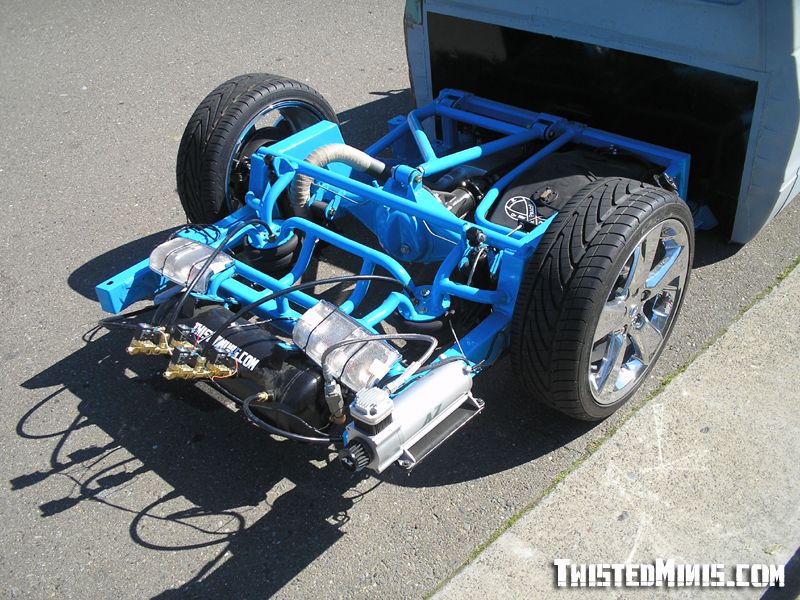

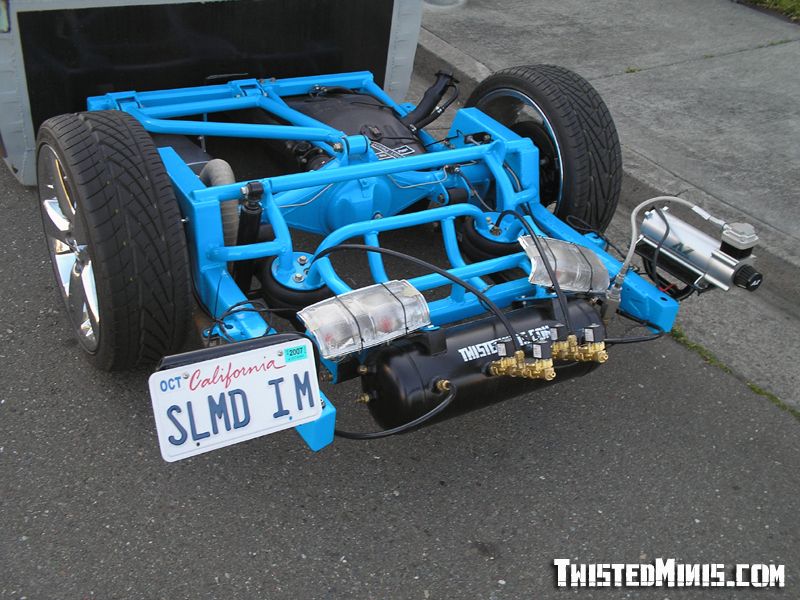

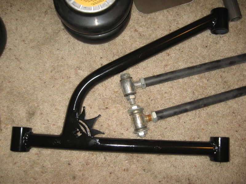

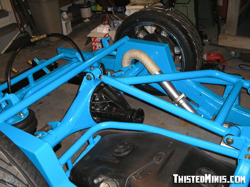

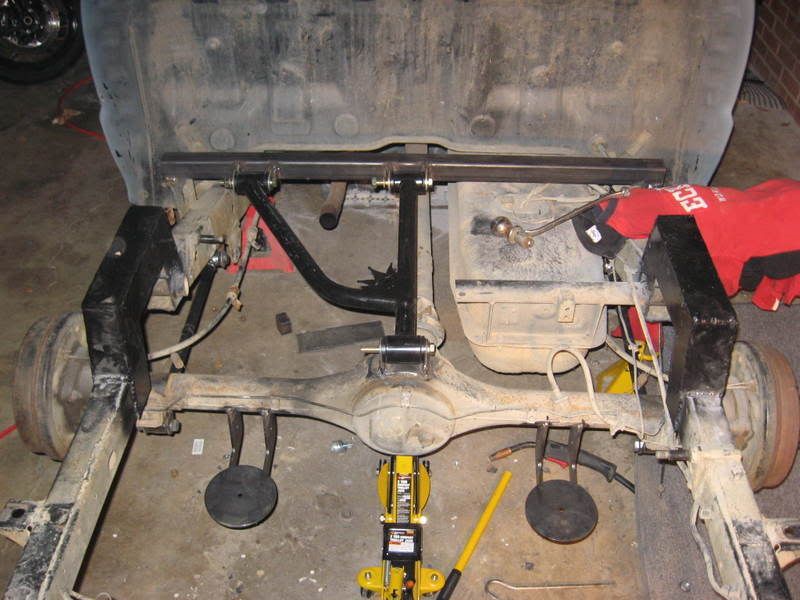

ok here ya go. i z'd the frame up 4 inches instead of notching it. raised the gas tank on top of the front mount and did a 3 link wishbone. everything is under the bed and the bed bolts back up (just 4 inches higher). so all you have to do is drop the bed to match and you have a full stock floor.
