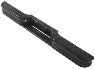

Ok, after looking for hitches I found this:
Replacement bumper
Which appears to be rated as a Class II hitch.
Before when I said that my bumper appears to be fine, I meant that it is structurally sound. But, it is pretty dinged up and has a hole about 8cm in diameter on the left side due to rust.
So: would this work?

You will be better off with a receiver type hitch mounted to the frame
futurdreamz's avatar
futurdreamz
may I ask why?
I checked the instructions for the custom receiver from the same site and it requires removing the bumper in order to be mounted between it and the frame, so it wouldn't really have a stronger mount than the bumper.
I won't be towing over 2,200lbs, so the bumper hitch should be durable enough.

You are always best off getting a frame mounted reciever...it is the strongest and most sound. Firstly because of the amount of tongue weight...you say the trailer is 2000lbs...but whats the tongues weight on that? Is there stuff mounted on the front of the trailer? IE..gas cans, sparetire...toolbox???? ETC.....
The wiring is not hard...I have a 4 pin round done on mine, I am using a bumper hitch with less than 250lbs tongue weight so no need for me to get a receiver although I prefer them overall.
futurdreamz
The tongue weight is only about 150lbs max. I can lift up the tongue in order to maneuver the trailer around by hand.
korrupt1's avatar
korrupt1
Then you should be ok with a bumper mount but the receiver is always stronger. I dont know what bumpers can hold...but you are only as strong as your weakest point...and with bumper being tied into a frame by brackets then bolts....that would be a failure spot if anything was to happen. with a receiver you know its bolted strasight onto frame direct
