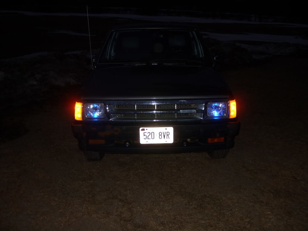

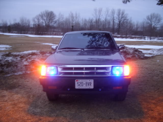

plumbous blimp
Here's the truck with the lights on (the dark one was taken with the flask on, why it's darker i don't know). The headlights weren't on, and they usually are when i'm driving. When the lights come on, they do give off some light, and on coming cars will notice the blue, hopefully the police don't care.
