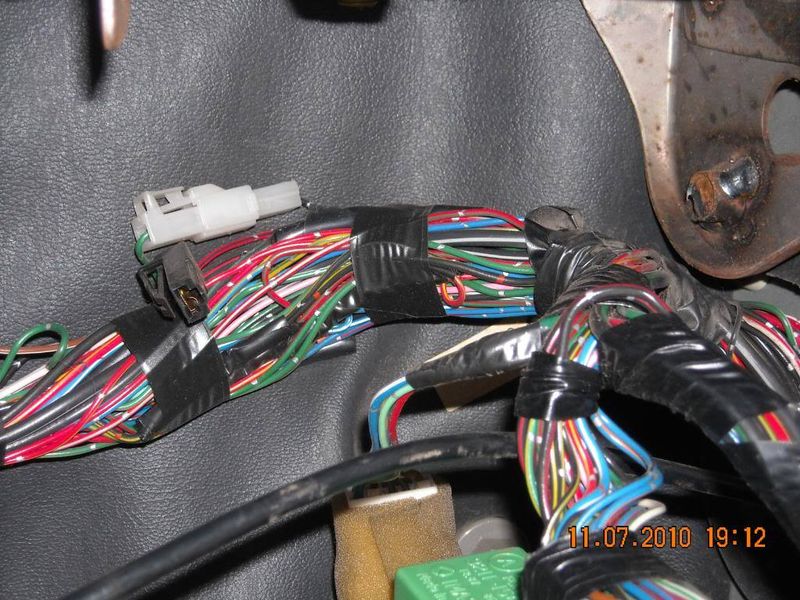

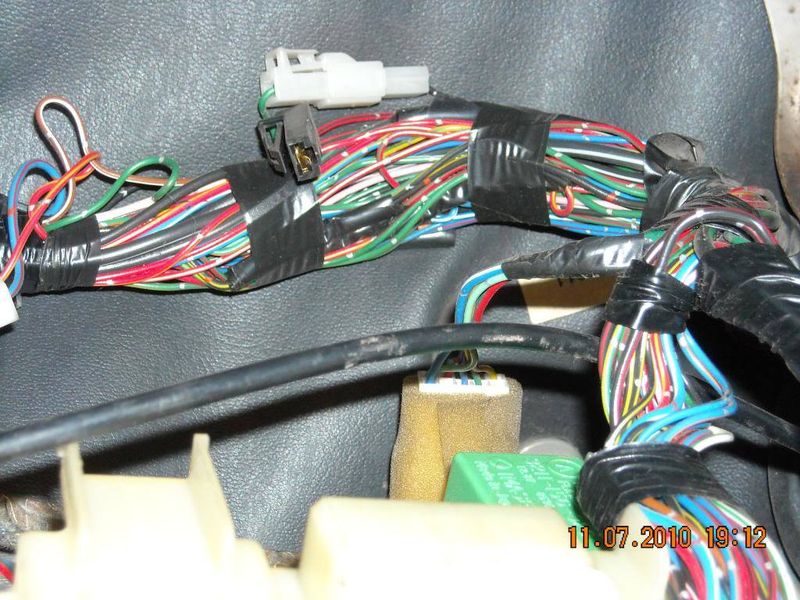

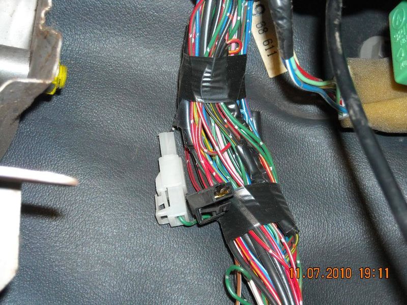

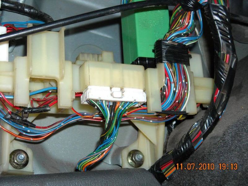

And how about a few pics of these connections under the drivers side dash? I had these in a similar thread for this over at MazdaTruckin.com before the Hindenburg hit it!
Here you can see the 2 white connectors are plugged into each other, well if you need to reset the check engine light (CEL) just unplug the 2 that are plugged into each other and swap out for the extra connector that is hanging out there also! In my case, I would have to plug one of the white connectors into the black connector that's staring at you right now in this picture!
These connectors are located right above this wire contraption which is right above the driver side kick panel.
You can see the connectors in this pic above the wire contraption!
