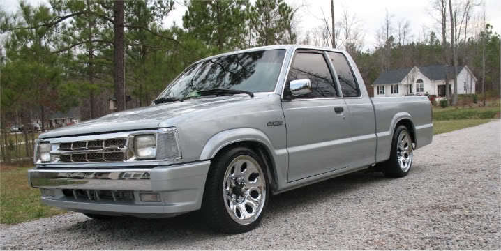

That's not true, My friends truck has the four inch angled drop blocks in the rear with re-indexed torsion (which is the same as crancking the torsions except your torsion bar bolt is tucked up there instead of hanging)in the front and it's fine. Here is the stance.
