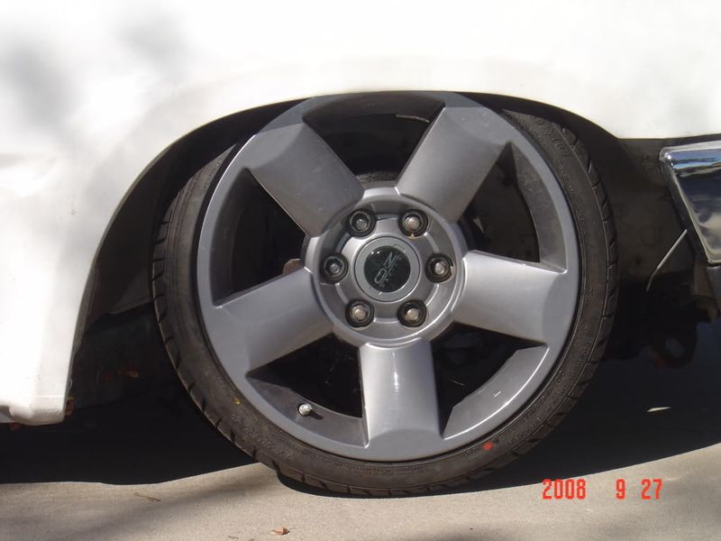

I have a 91 B2200 i'm not bagging. I've got DJM Lower Control Arms. The stock Armada 5 spoke 6 lug rims have an offset of +25 mm. I was wondering if i could run these without any clearance issues. I've been away from B-series trucks for well over 10 years now and have forgotten alot about various offsets. Anyway i searched the forum and didn't come away with anything. So any help would be greatly appreciated. Oh and the truck will only have a static drop of 3 to 4 inches up front and maybe 4 or 5 inches out back. Thanks alot. L8R.
droppedmydawg
I am running those, you have to bore out the center .660". Other than that they look bitchin on a Btruck. You can drop it too if you run 4X4 sheet metal.
