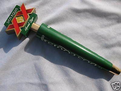

thanks Dev, heres the tap handle that i got on ebay for $20 shipped i love this beer!!

3/8&quot; is really close to 10mm, if you have any dies try turning one on by hand and just find the match
bgdb26k
yea the tap handle is 3/8&quot; i would rather not modify the shifter if i dont have to, just in case someday i need to switch it back to stock knob
devb22's avatar
devb22
You are going to have to make an adapter then buddy!
take a piece of round stock, and tap one end 10mm to fit the shifter threads, and tap the other end to 3/8&quot; for the tap handle.....Then take a piece of 3/8&quot; all thread to attach the tap handle to the shifter....
