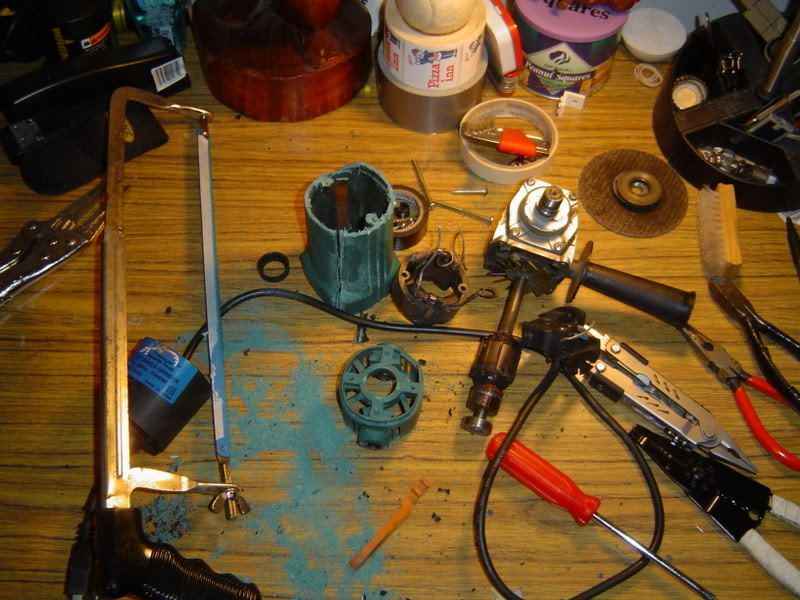

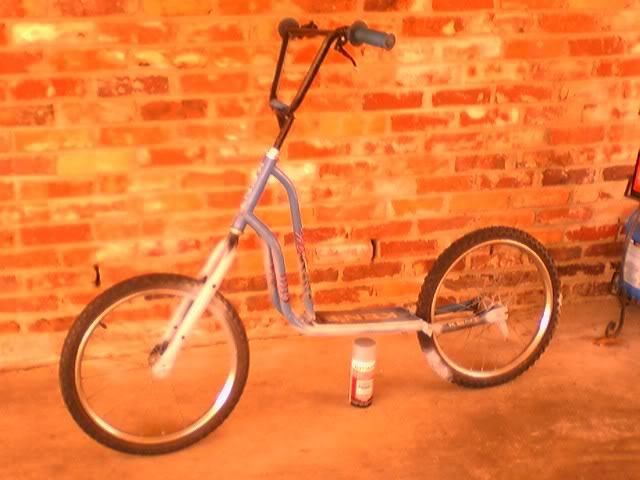

i finished my scooter project this past week and i practiced welding some 3/16 1x1 steel with my little lincoln welder. and my grinder died on me so i took it apart. here are the pics
immortal1 (linn)'s avatar
immortal1 (linn)
I think I may have figured out the problem with your grinder. Most grinders use blue dust to run correctly. When the blue dust leaks out - they stop running;-)
gravity5's avatar
gravity5
did you take the grinder apart with the hacksaw....LOL
madbagger's avatar
madbagger
yea the blue dust is from the case being sawed apart. it was smoking and sparking alot the last time i used it so i figured i had nothing to lose when i took it apart
gravity5's avatar
gravity5
sometime that sparks and smoke is form dirty internal or worn internal parts, of which you can almost always buy from an electric motor repair shop...
madbagger's avatar
madbagger
i wish i had thought of that b4 i took it apart. haha oh well it only cost me $10 new and Christmas is comin up soon so i can upgrade b4 i start workin on my truck

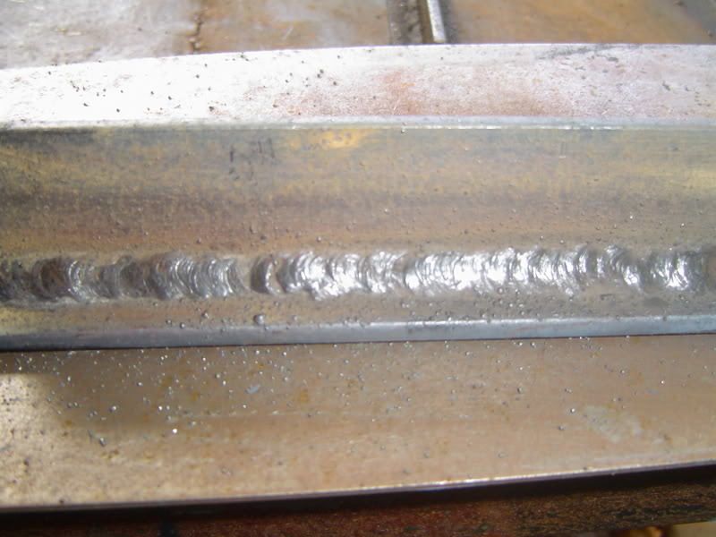

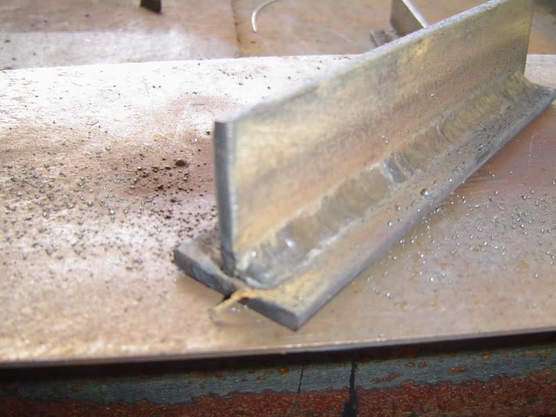

are my welds lookin any good?
pont's avatar
pont
get a pic of the other side you can have welds that "look good" but are pure crap take a pic of the other side and we can see how the penatrion(sp) is
gravity5's avatar
gravity5
the weld look good on the surface.....but at the very beggining of the weld you can clearly see the lack of penetration.....
a couple tricks....1" clean the metal very good...any rust or scale will adversly affect the quality of the weld... and 2 make sure the metal is heated up a little....that way it is easier for the welder, at least the little 110v ones to penetrate....this should not be a problem on any decent 220v welder.
Also maybe turn the heat up higher if you can.
pont's avatar
pont
Yea I saw that I wonted to see if it got any better in the middle or at any point.
madbagger's avatar
madbagger
i dont think a pic of the other side would do any good bc i welded both sides. i have a 110v welder and its turned all the way up to weld 3/16". i see what u mean about the beginning of my weld im gonna bave to work on that.
on my welder it also says that for it to weld 3/16" you have to do multiple passes. does that mean multiple passes on top of each other or a single pass on both sides of the metal?
