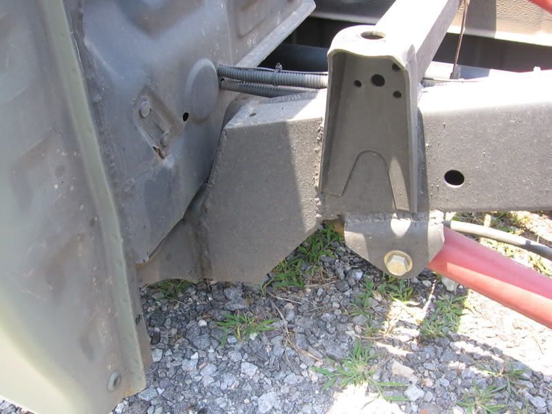

ACTUALLY...look at this. Mazdawg[mikey] actually Z'd the back of his frame instead of notching it
Food for thought!
