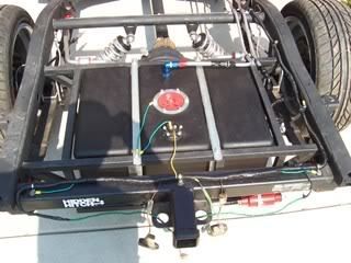

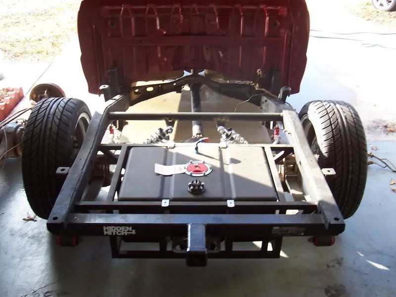

here is a pic or two of my set up, I cut out the spare tire holder & welded in a 1" x 1" square tube frame, it is a Jaz 16 gal Pro street Fuel cell w/ sump from jegs it'll run you @ $190...and about $40 for the tubing, then time to weld it in...that's just how I did it, some of the guys mount it in the bed, some under, some run the plastic cells like mine, some run the aluminum ones....

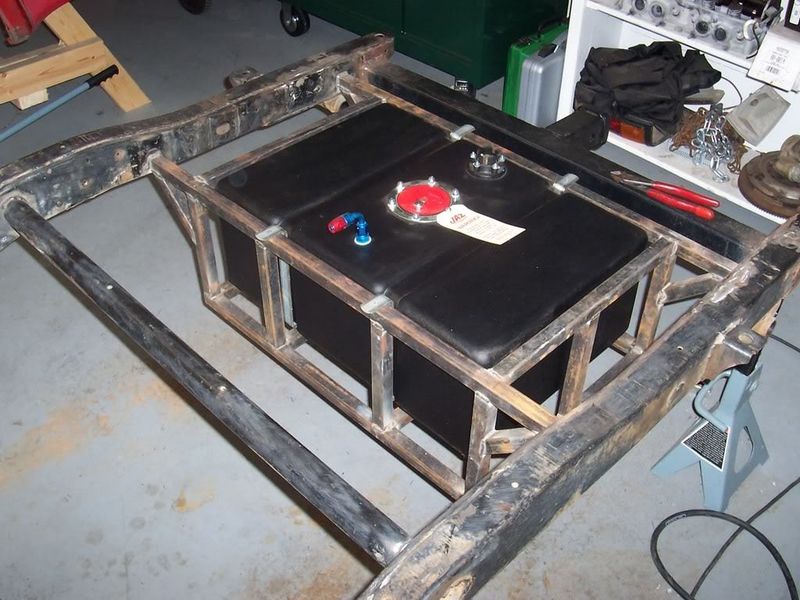

some pics. If interested it is 25 5/8" square X 9" deep. It should fit between most frame rails.

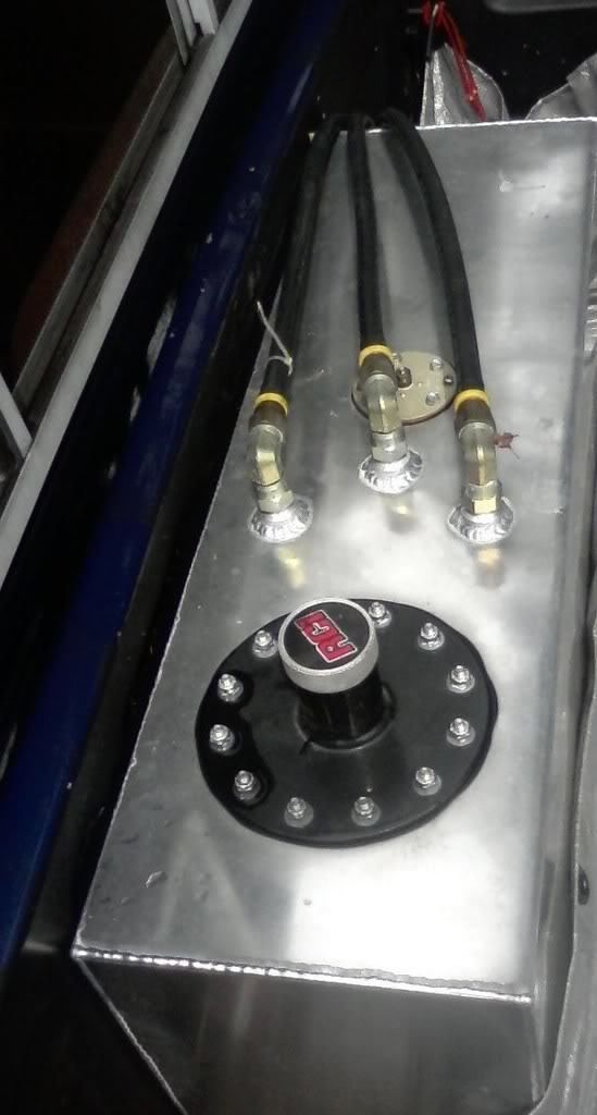

Here is my setup. It has been in my truck since 1995 and has never given me trouble. I bought an RCI brand fuel cell and made sure it held pretty close to the same amount of gas as my factory tank. ( it actually held a slight bit more) I got the one that was about the same height. That way I could just transfer my factory sending unit over into he fuel cell and I did not have to try to adapt my gas gauge to an american style sending unit. It works like a charm and I actually have a spare gallon when my tank reads empty so I never have to worry about gas...
