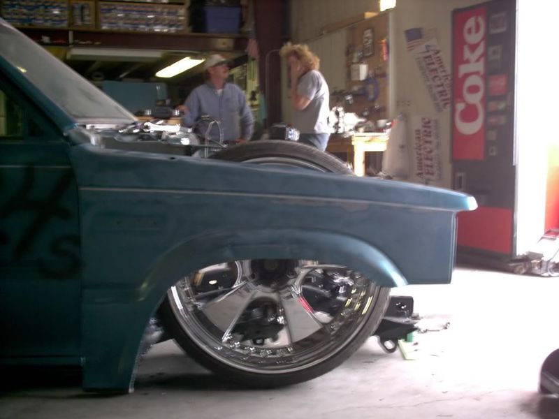

well, if i bodied it 2 3/4 inchs the wheels would stick out 2 3/4 inchs. if i did body it i would make a trick hood that looks stock then when i lays out it push's the sides up. but right now im kinda getting away from the idea of bd'ng it. this is what itd look like laying rocker on the 24's.
