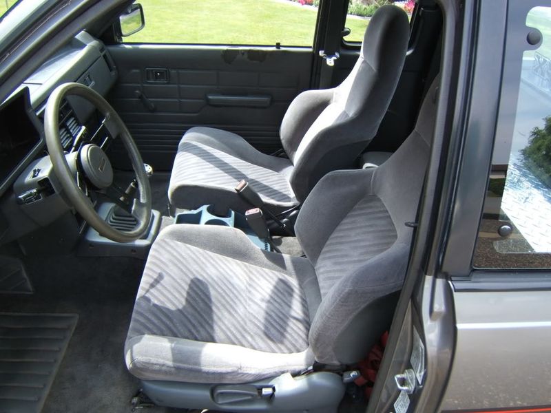

I have the door panels which extend all the way to the glass. There is no metal piece at the very top. You can see which panels I have in this picture.
If I get a set of door panels which do have the metal piece, will all the installation holes fit the same?

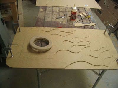

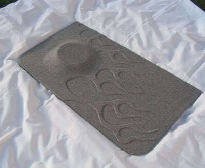

Or you can make your own like these. There is a tech, "how to" article on here.
1lob2k
Sierra, do you have any pics of full panels that you have done? want to do mine, but not that smart.
he has write up somewhere on those panels

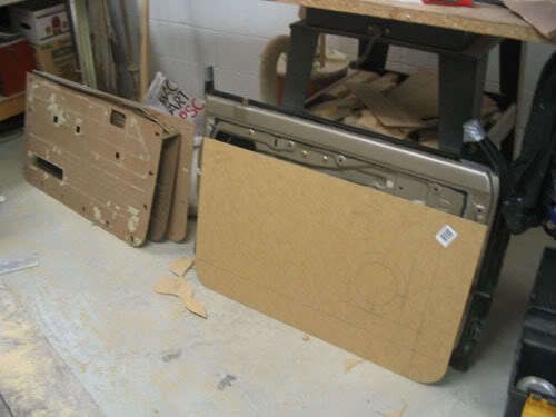

***Also, if you use your old full panel as a template for a new one, make sure you add on to the top of the panel and add the new clip holes( I think that its a half an inch). To figure it out just put your panels back on the door once you have them apart you will see the gap between your old panel and the top part of the door. Just measure the gap and add it to the top of your panel.
