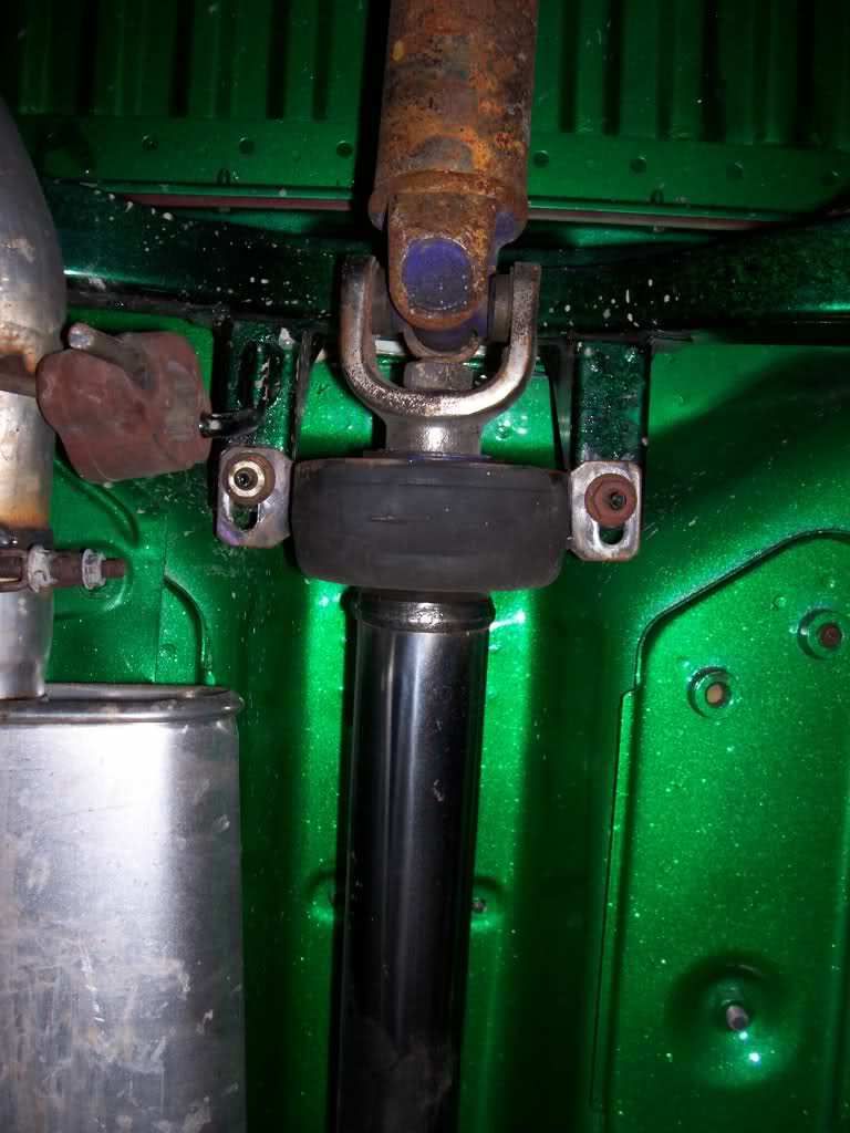

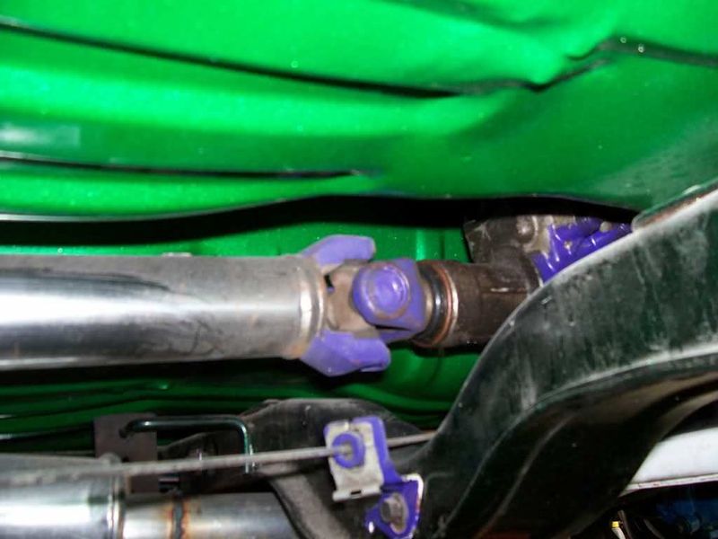

Okay so I'd prefer if a few of you could get me some pictures.
Crawl under that truck of yours and take a picture of the driveshaft that goes into the transmission. As well take a picture of the carrier bearing.
What I'm trying to do is see if I have my driveshaft plunged too far into the tranny. What I suspect is that when me and my bro did my clutch we bolted the shaft back on and went too far in. Hence why I have a paculiar noise at the tranny that is getting on my nerves! If anyone can snap some fore me, I'd REALLY appreciate it!
If you can, take them looking straight up at the shaft from below!

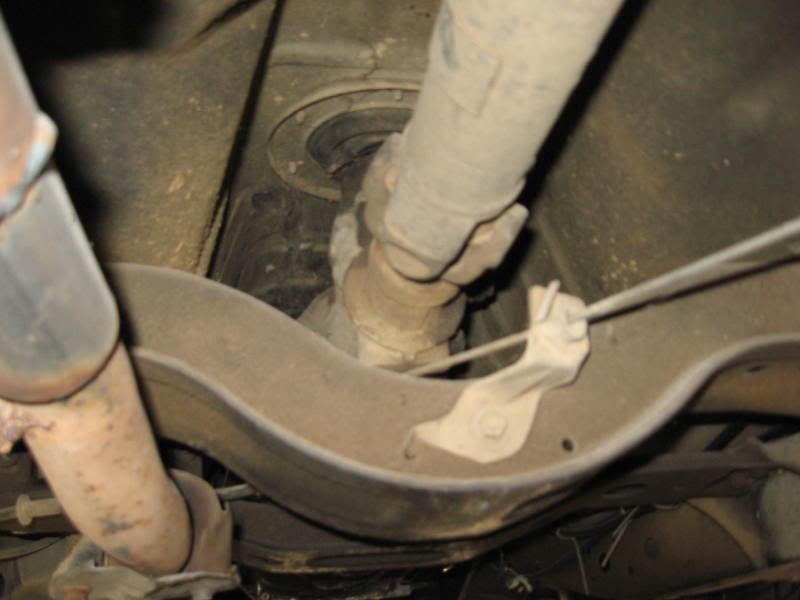

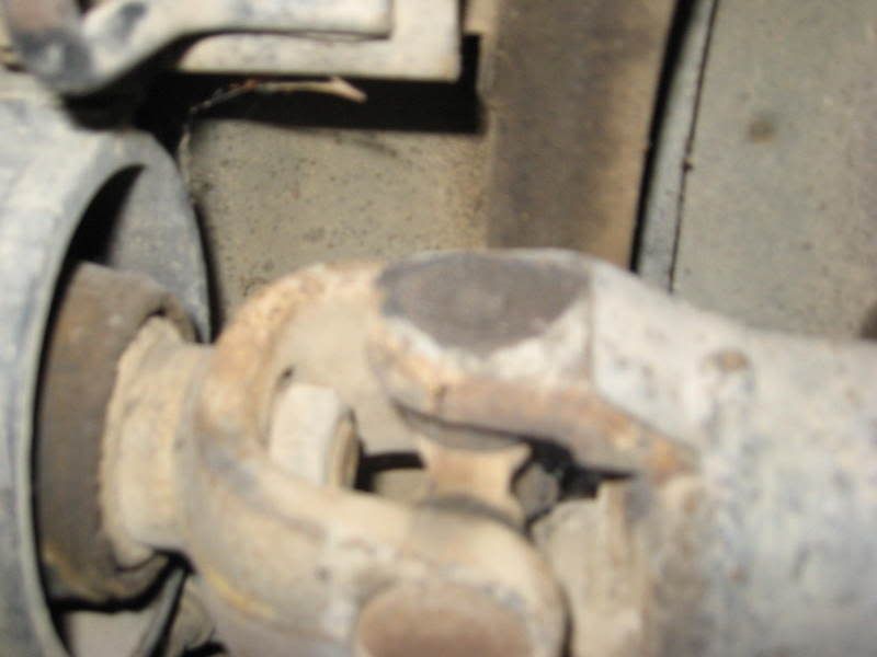

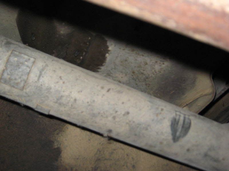

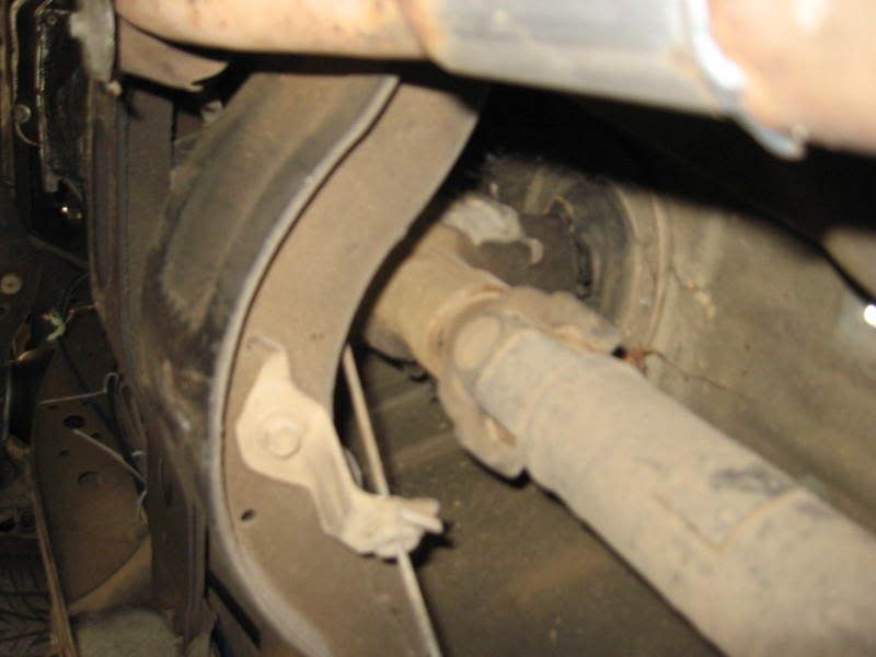

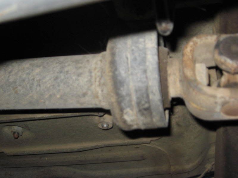

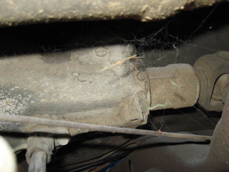

Best I could do man, Sorry for the bad pics..
hex0rz
Hahaha! You got COB WEBS up in there! WHAT!
Hey man, I thank you for atleast doing it for me! It should be a good reference. I was hoping for some carrier bearing pics too but thats okay. I'll compare these with mine and see what I got.

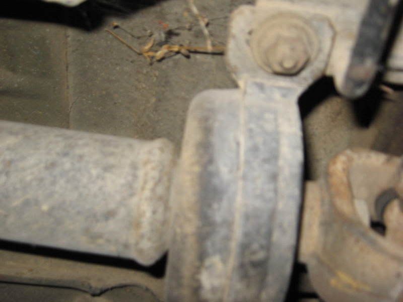

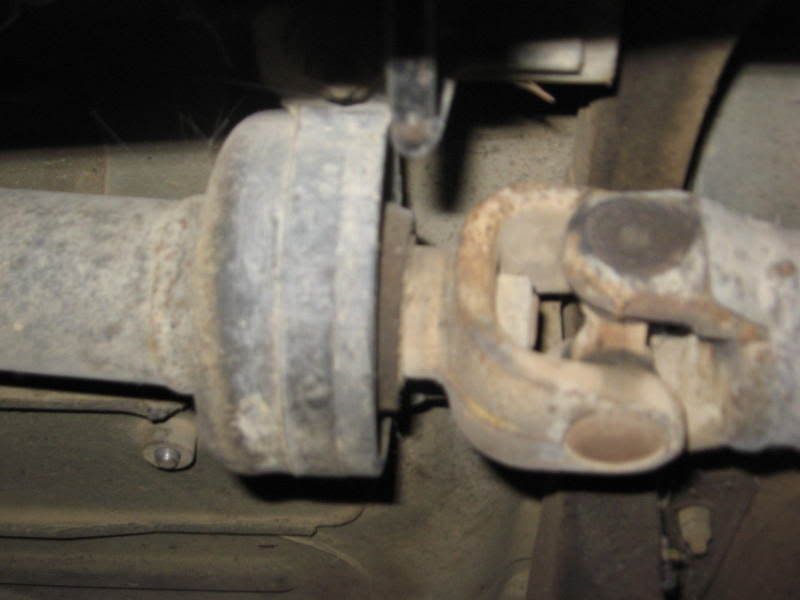

Ill take a carrier bearing one for you right now, Hopefully the flash will come out okay, Yea I got cob webs lol, The truck sits a lot, lol
slammedyota91's avatar
slammedyota91
Sorry theyre not the best, but its the best I could do without being able to see.
