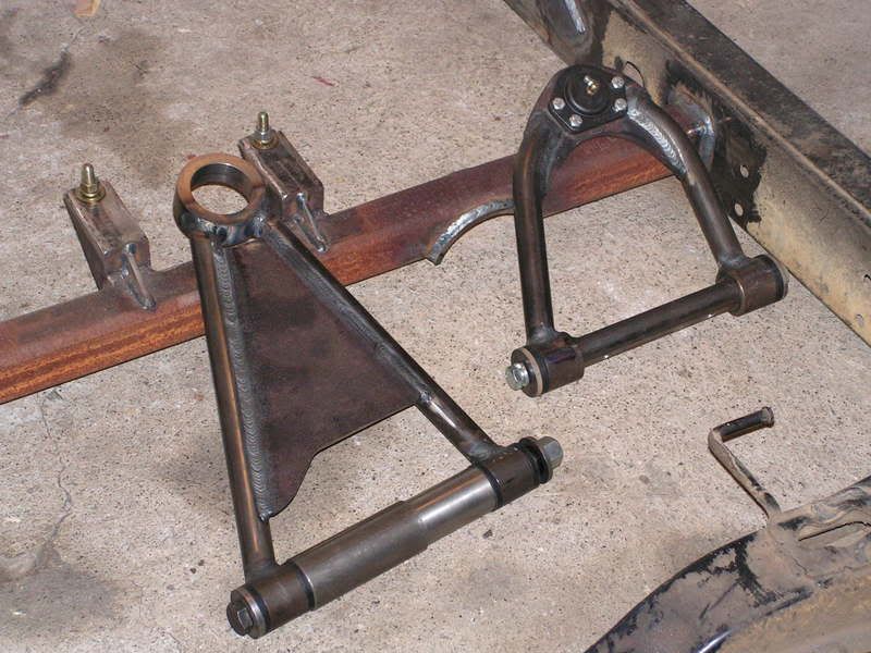

Mine had a 2 piece drive-shaft. To get the angle right between the first driveshaft and second, i had to make a new carrier bearing crossmember. Ended up raising the carrier bearing about 1 1/2". You want more than 1/2 of a degree but no more than 3 degrees between each joint. Thats how i set mine up. By raising my carrier bearing it brought my driveshaft angles in. Took me a couple of days messing with it before i got it right. Heres a pic of the carrier bearing crossmember that i made, sorry about the control arms being in the way.
