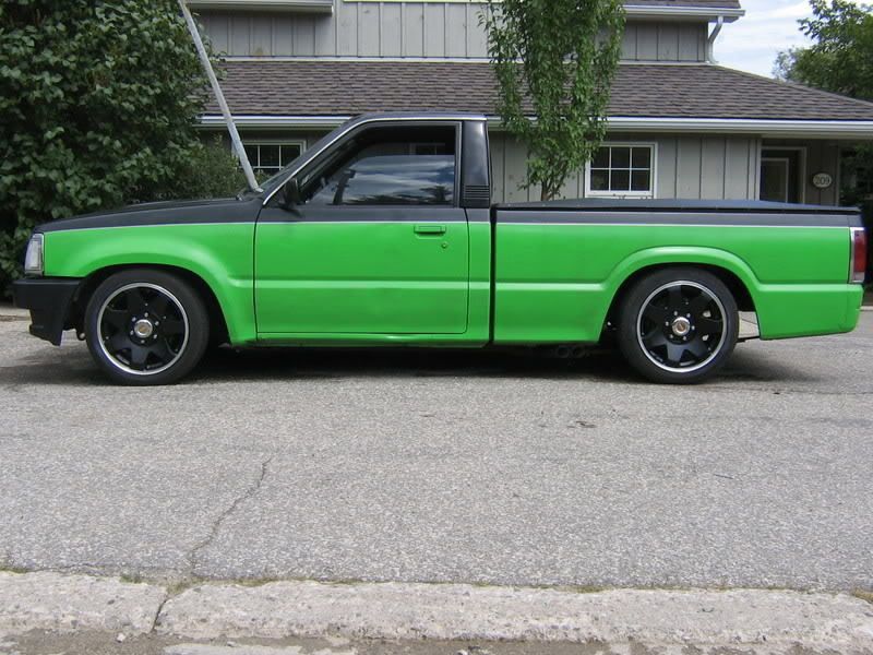

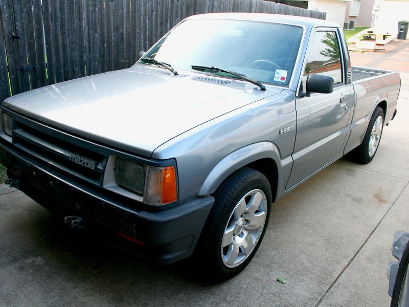

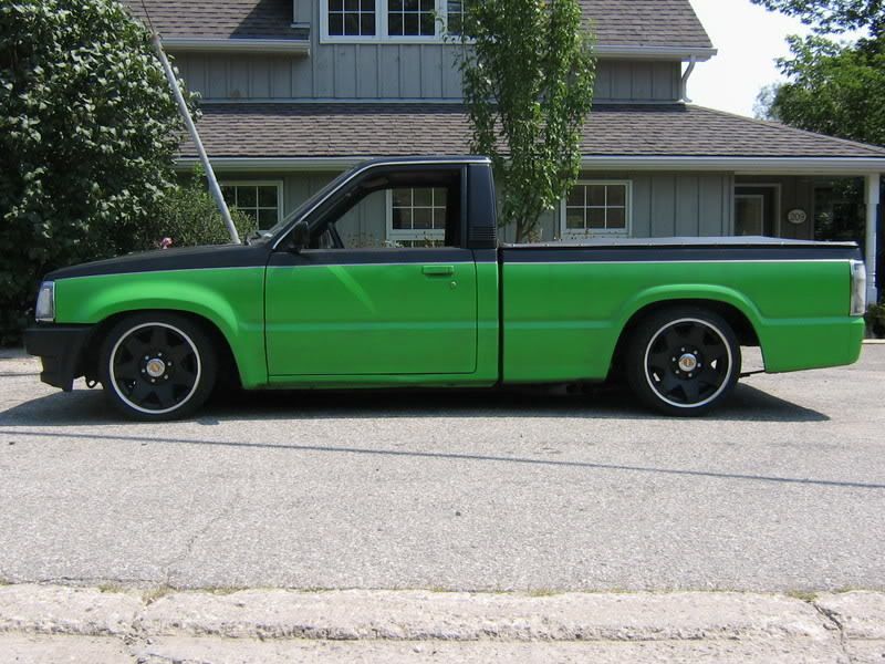

Here's the difference:
Stock wheels,3" blocks,monoleafs
205/50/17,3" blocks,monoleafs. This is pretty much the closest you'll get to the stock overall diameter.
205/40/17,3" blocks,monoleafs. Big difference in ride height. Much lower,and threw my speedo off by about 10kmh. When I was doing 90kmh it would be reading about 100kmh. These looked about 'right'.

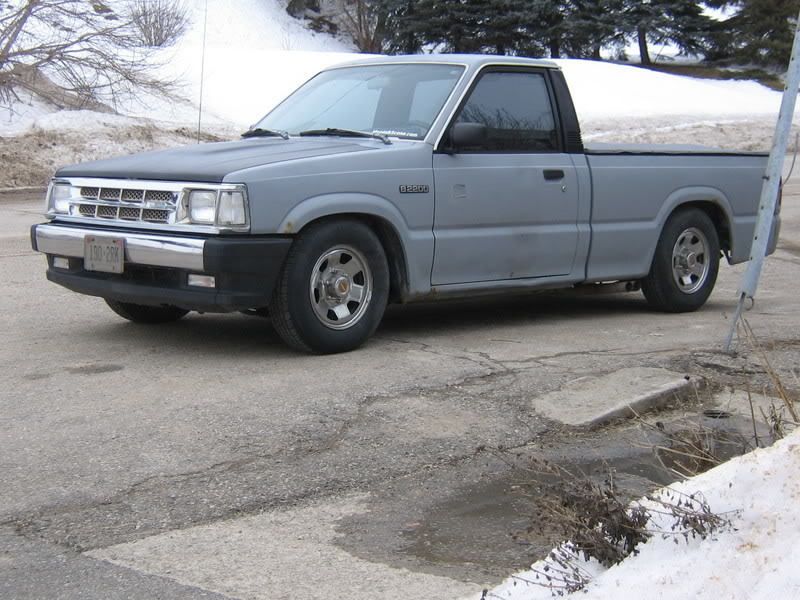

Pic of the install:
I don't think any tire size combo on the FJ Cruiser rims will tuck (maybe with 4wd metal). The outer lip of the rim is even with the small fender flare on my truck, and the tire is just a bit outside of that.
