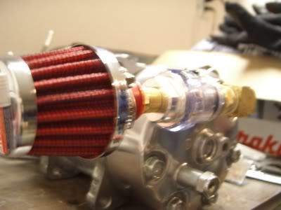

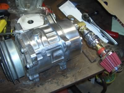

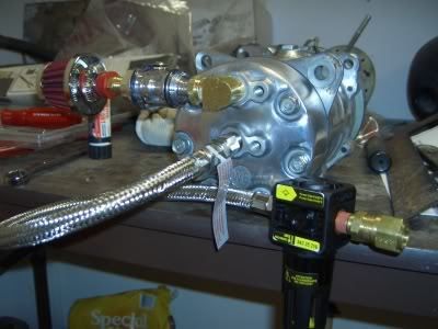

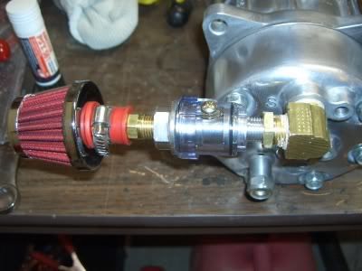

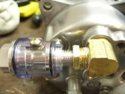

I did it fist you need to find out witch line is the inlet and the outlet. Than run a oiler to the inlet and a oil separator on the outlet line make sure you run steel braided line to the tank and run a water/oil trap at the tank as well as a check valve. if you need more info let me no and I can take some pic's

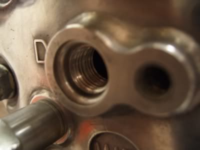

so would the skinny line be the inlet line? thanks so far. pics would be great

I took the rear cap of the compressor and had it tapped at the machine shop.
1/4" pipe thread on the discharge, 3/8" pipe thread on the suck side.

The fittings I got from the local Parker store and used it to hook the in-line oiler i got from sears and the filter from autozone.

I couldn't keep the thing oiled so I would recommend a bigger oiler than the one I had. Also, with the fittings I had on there they got in the way of the header so they had to go. A blow off valve is a MUST. Again, A BLOW OFF VALVEW IS A MUST!!! That's what happened to mine. My pressure switch messed up and it blew my oil separator to pieces. I got discouraged after that and got two viair 380's. The EDC pumps air like mad.

make sure you run steel braided line all the way to the tank and run a oil separator and a water/oil trap two will help catch all the oil coming in the tank and it helps to run a drain plug on your tank as well. by the way you will love how fast your tank fills.
