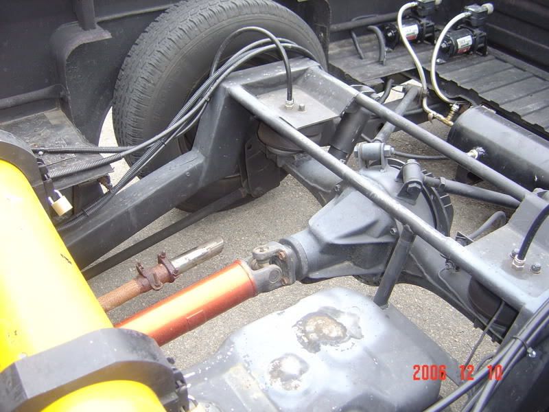

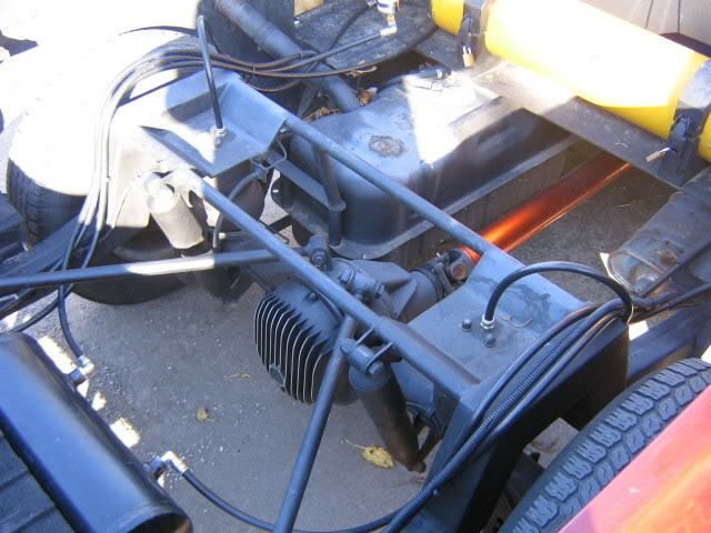

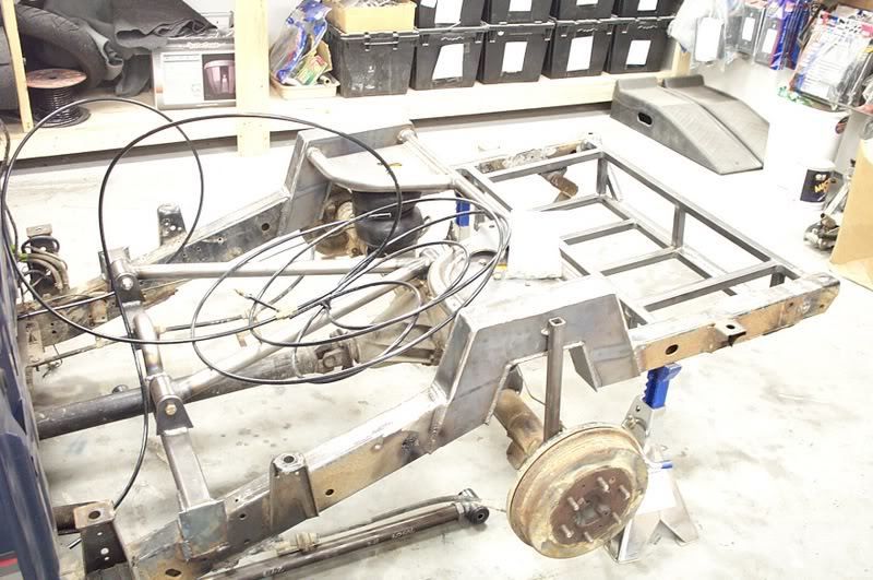

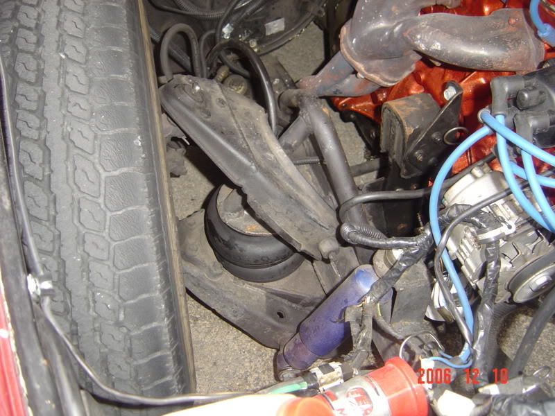

Hey guys, I Need as Many pictures of Rear end setups, Bags over Axle, and/or Bags on Bars As Possible!! as well as Front Setups!!!! Please Any and All pictures will be appreicated, Going to talk to my Fab guy monday morning, He wants to see some pictures, as he said...."A Pictures worth a million words"... Which it is... Thanks guys.

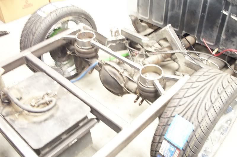

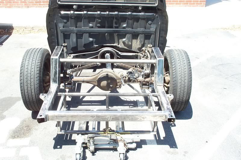

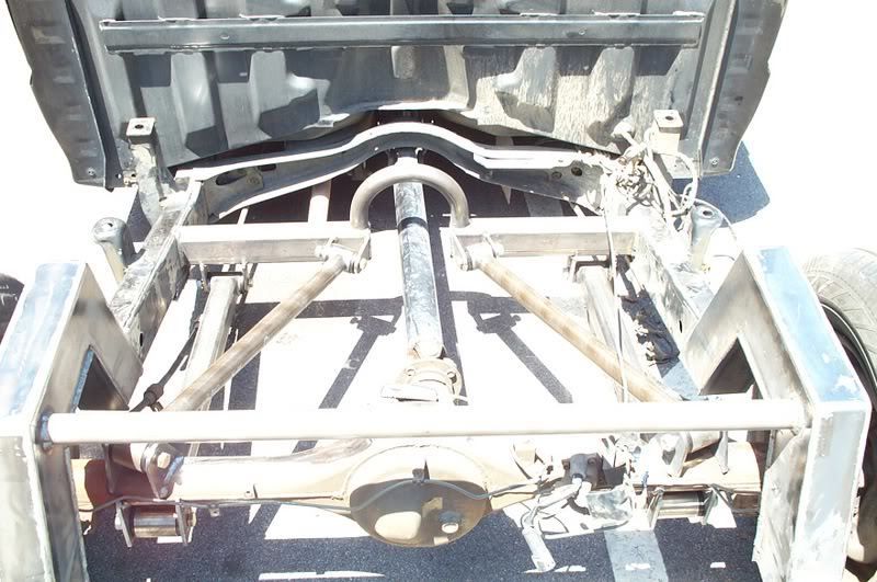

pics of the 83...
hope this helps. and don't do a 50/50 4 link like mine. have all 4 bars going from the axle forward. i hate the way it handles. but i talked to the guy that bagged it and the reason he did it that way was to keep the gas tak in the stock location (only raised it up 3" for clearance) instead of doing a bunch of relocating. he just wanted to drag it.

Hows the Lift and Ride on Bags over Axle? heard the Ride was Shit, and Bouncey?
maztang (ryan)'s avatar
maztang (ryan)
i have no complaints. i am going to redo everything with bags over bars for the fact that you get more lift and better ride quality. i guess it is a little bouncey but the 50/50 makes for a realy strange ride. kind of imagine when your washing machine gets all the clothes on one little spot, how it wobbles...that is what it feels like when going over numerous bumps.

It is his First "Complete" Air bag suspension, With Torsions, he wants pictures for Reference to see exactly what i want done...cause pictures speak a million words.
