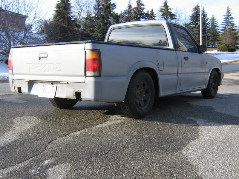

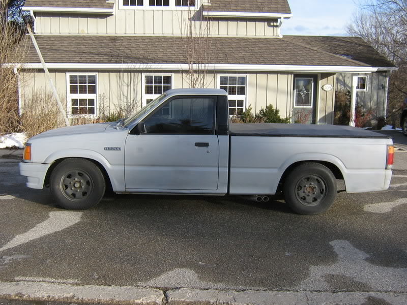

So,$1100 poorer,I now have a truck I can say is definetly 100x cooler than it was before.
Wednesday I got the truck lowered and took the day off work to help out with the drop. I got a set of Toxic shocks and 3" Belltech blocks,removed 2 leafs on each side,cranked down the t-bars and flipped the ball joints. I haven't had a chance to cut the bumpstops yet,so the frame is sitting on them,front and back. The ride is also better than I expected,and the handling is fantastic. This morning I just had a custom exhaust made using 2.25" piping,a Magnaflow high flow cat,Dynamax muffler and a custom made dual tip. It now exits under the bed infront of the wheel. Sounds really good. Quiet while cruising,and throaty when on the Go pedal. It also seems like I've gained a huge amount of power,because this truck absolutely scoots along now.
Monday morning I should be installing my chrome bumper and my 4x4 grille,and my clear corners and Bscene sticker should be arriving this coming week.
So,let's take a look at 'er now!
It's so low now,I can only get 2 fingers between the top of the back tire and the fender,and 1 between the top of the front tire and the fender. Can't wait till I put my Pathys on. It'll look even better.
So whatcha guys think? I've been waiting 10 months for this!! I am soooo freakin happy now. <img src="{SMILIES_PATH}/icon_biggrin.gif" alt=":D" title="Very Happy" /><!-- s:D --> I LOVE MY TRUCK

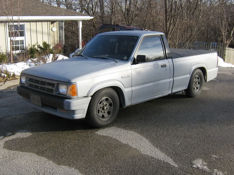

Here's a reference for stock height:
I think she's just a little lower now eh?
