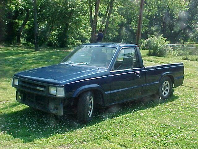

pull those torsions, pull a couple leafs throw some blocks under that rear end and ull set like this.....
