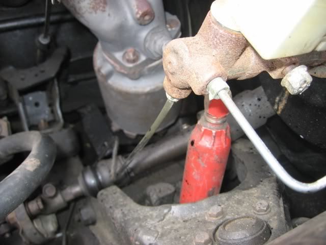

alright. Well my whole brake system was redone, all the lines were ran behind the dash to make the firewall look cleaner..
I went and took some pics of how its setup.

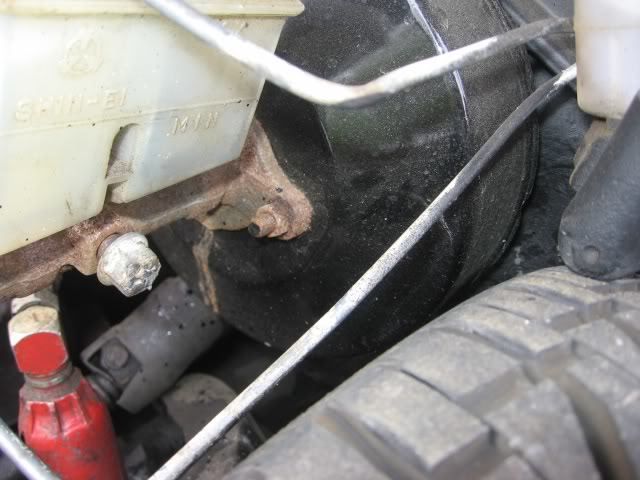

It looks like theres 3 lines off the master cyl.
1 goes directly to the front drivers side brake
1 goes behind the firewall, and i assume is for the passenger front brake, And the other is for the rear brakes.
The brakeline thats disconnected and plugged in the master cyl, is for the rear brakes. i blew a brake line on the rear axle and to get me home, i disconnected the rear brakes.

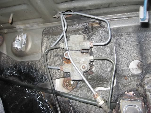

This i assume is the proportioning valve. its behind the dash mounted on the firewall. I dont know if its hooked up right or not.

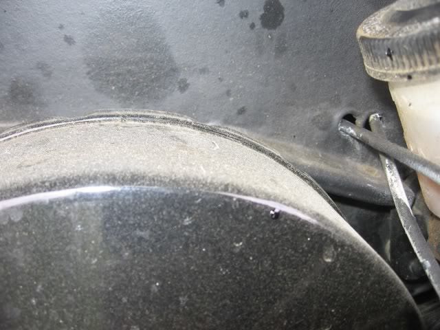

Notice all the brake dust on the drivers side wheel
Notice the lack of brake dust on the passenger side wheel

That is the proportioning valve in the picture but I have no idea if its hooked up the same or not.
