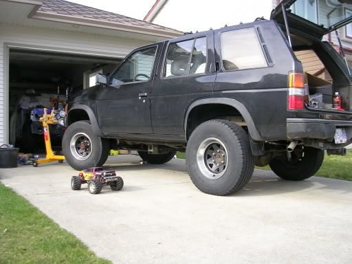

Maz, you got a Pathfinder? That vehicle could contain some potential upgrades for us beyond the disc brake rear. I like the seats, the front discs are the same style but larger, twin piston calipers, larger master cylinder, etc.
maz
here it is after I put in the 4 inch lift I need to do One prjrct at a time lol
