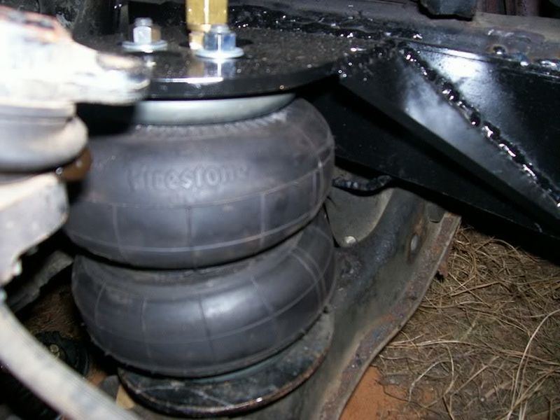

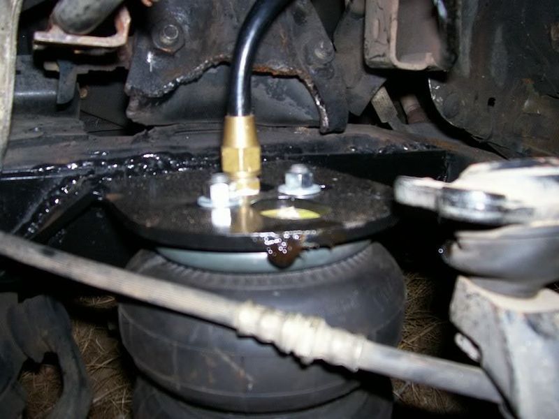

here are some pics of my brackets before they got bent upward

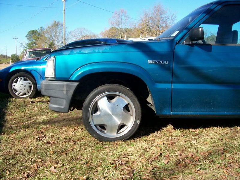

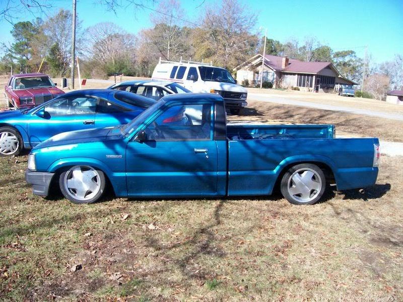

here are some pics of my truck both up and down

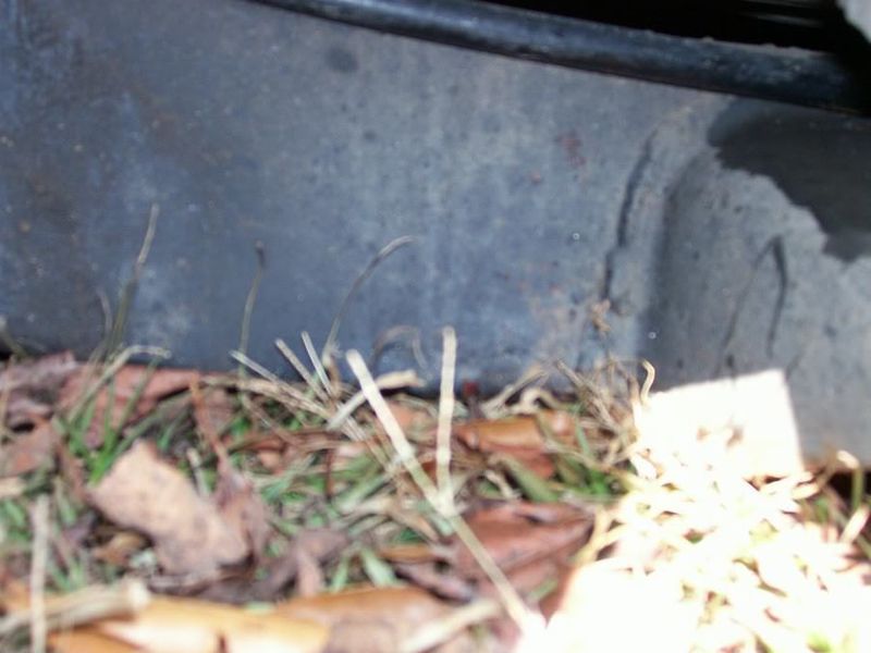

thats my frame

the bag mount seems to be fine, looks like you bent the upper arm assembly
looks to me like you cut too much out of the hump, to fix that you can just hammer that assembly back straight and run a gusset from the upper mount plate to the upper arm tower
