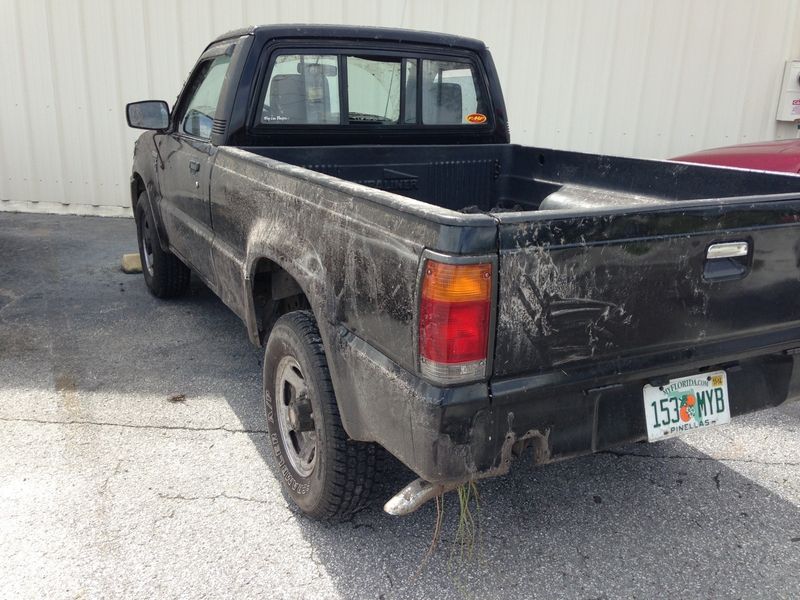

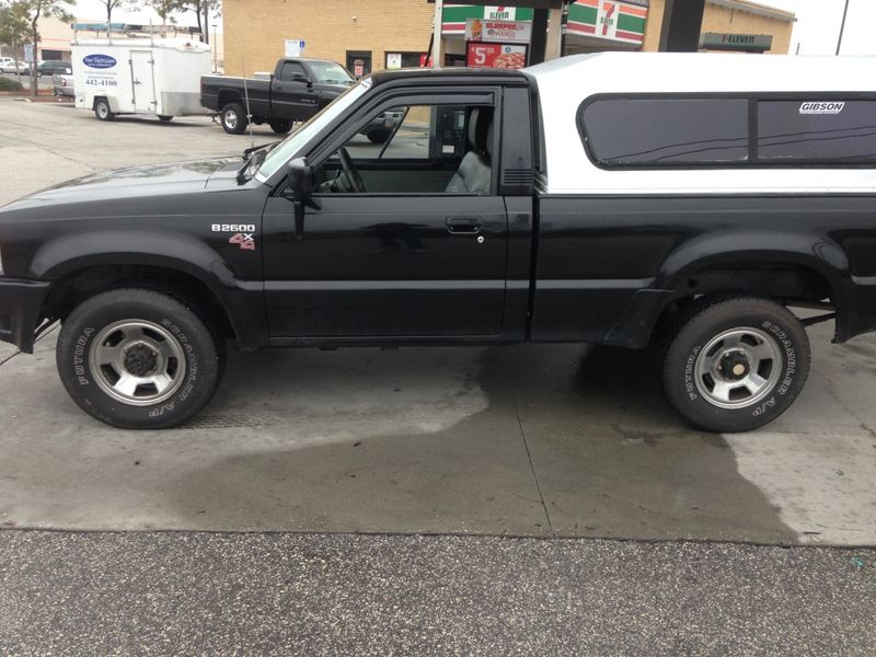

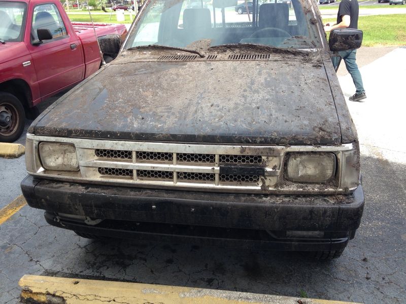

Im a new member but i know most like the lowered mazda style and i got respect for it but this is a offroad 4x4 mazda project
So I've had this truck for awhile now and its been amazing. Its got the 2.6 mitsubishi engine that people hate but i love it. I want to do more mods but so far entirely new exhaust, thrush muffler, pacesetter header, chinese weber 32/36 e choke carb, (works great lol), Optima yellow battery, new vpower ngk plug ( i went hotter), and some other random stuff...i can't remember. advanced timing and some other tuning stuff in the carb double pumper. She has good power for an all torque no power engine. 4x4 works great i offroad regularly and it does surprisingly well. I want to run bigger tires and get a slight lift on my truck. I want to do a torsion lift and some blocks in the back and run 31x10.50 tires on maybe some GM 6 lug rims. Eventually i plan to turbo the motor or just get a used Starion engine and swap. Truck is original though and i even got original window sticker. IT went for around 12k or so new. Ive already got my moneys worth.
im gonna add more pics

That thing looks like its in minty fresh condition, any rust? Is it original paint? You should post a picture of the window sticker.
