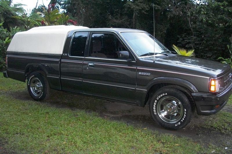

Hi everybody, I have been lurking around for a while. I have a 88 B2200 bought about a year ago and since I got it have had to solve little issues but so far ok. The only thing is that since day one I have been getting no more than 17 - 18 mpg and after reading around I have decided to install a new 32/36 Weber, the truck is stock with all the vacumm lines, catalytic converter etc. but I am no expert to go around diagnosing all those miles of lines. What I am looking for is mileage and not necessarily power or speed. Anyway glad to be here.

Great looking truck.
