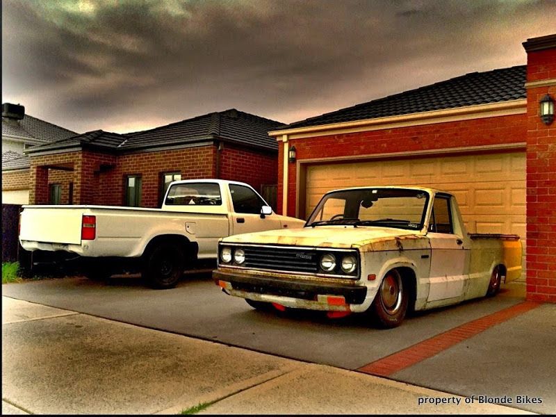

im currently building my girlfriends first car. 84 B2200 Diesel RAT Truck.
1981 Mazda B2200
2.2 liter diesel
5 speed manual

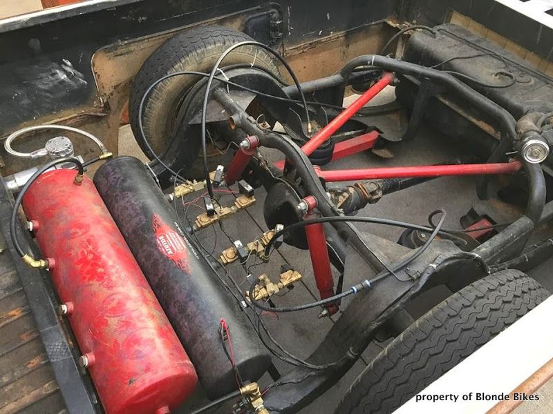

Triangulated 4 link
DW notch
Slam bags
Front has 3/8 valves and rear has 1/2
Have spare valves of both sizes and will see which my girl likes best.
Twin viair 480c pumps with twin tanks. with both 160 and 200psi pressure regs.
still have some work to do. the tub liner needs to be redone. and compartment for storage. along with some 10mm sheet metal on the underside for that midnight sparkle.

That thing is sweet now if you could just ship it to washington usa that would be nice...
b2200rat
hahaha. yeah. wont go very far atm.
the box is shagged. trying to find another one.
mymmeryloss's avatar
mymmeryloss
Damn that looks good
b2200rat
Hey cheers mate.
Got a handful of things to complete. Along with a gearbox. And it's off to get engineered.
