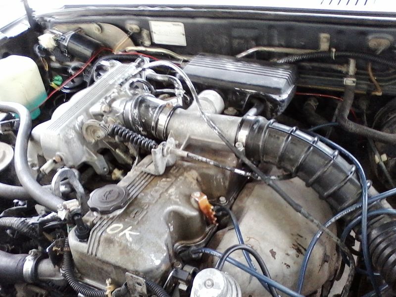

I have torn down head and rebuilt with new head new valves and seals
now tore out entire dash system
replacing coolant heater core with electric core
bypassing jenky plastic flow valve and multiple small connections
will install 150w rheostat and relay connection to replace old thermo control
